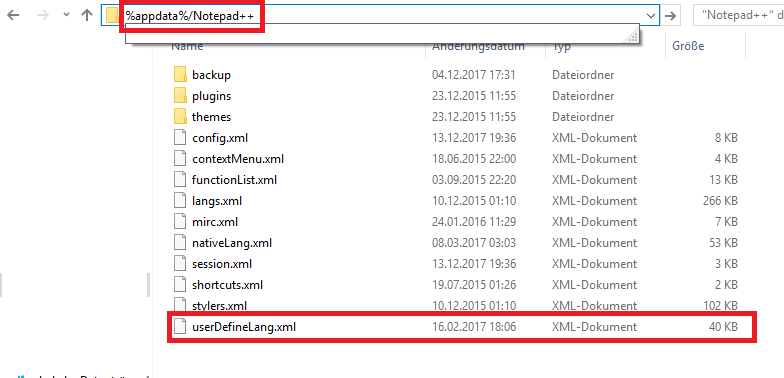

Beware, that you have to merge them together in the userDefineLang.xml file.
Thank you, @Confectrician. I try to import file from menu Language- Define you Language - Import and get Import Fail Error.
Does the important exactle file name - “userDefineLang.xml”. Can you share yours userDefineLang.xml?

Here it is:
You can reach the correct folder with the line i typed in the windows explorer.
