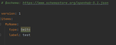

Automatically link the file to the schema
At the top of the file enter
# $schema: https://www.schemastore.org/openhab-5.1.json
That way the file will always and automatically validated against the schema

I checked again:
The “Select it for a file” does work, the " Automatically link the file to the schema" does not.
