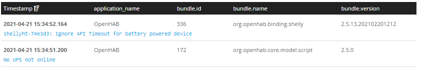

So I played with graylog today, and thoguht it’d be nice to have openhab going in there.
I’ve found a couple of threads and have now managed to get both my events log and openhab log going to graylog. I put in a couple of streams and it can now split them back out again…not bad.
So ignoring the times, these are about the same messages, We can tell the ones from the shelly binding as they appear under bundle name and id.
But on script entries, we have the data in the square brackets with the name of the Script, eg the UPSCheckRule that I run.
Does anyone know how I might get that script name to be passed to syslog/graylog?

I was able to switch it to a patterned format, but that seems to bust all the bundle id etc. How does the RFC5424 format know about bundle.id and bundle.name? and would be possible to get a bundle.script or something?

        Msg: 1 2021-04-21T15:58:34.007+12:00 melkor OpenHAB 22 - [mdc@18060 bundle.id="149" bundle.name="org.openhab.core.io.monitor" bundle.version="2.5.0"] logreader:reader:openhablog:newWarningEvent triggered 2021-04-21 15:58:33.311 [WARN ] [e.model.script.DP-DAY-CentralHeating] - (3.1) Keeping the heating in the current state
Any way we can fiddle with those mdc values bundle.name etc? and add a new one?
