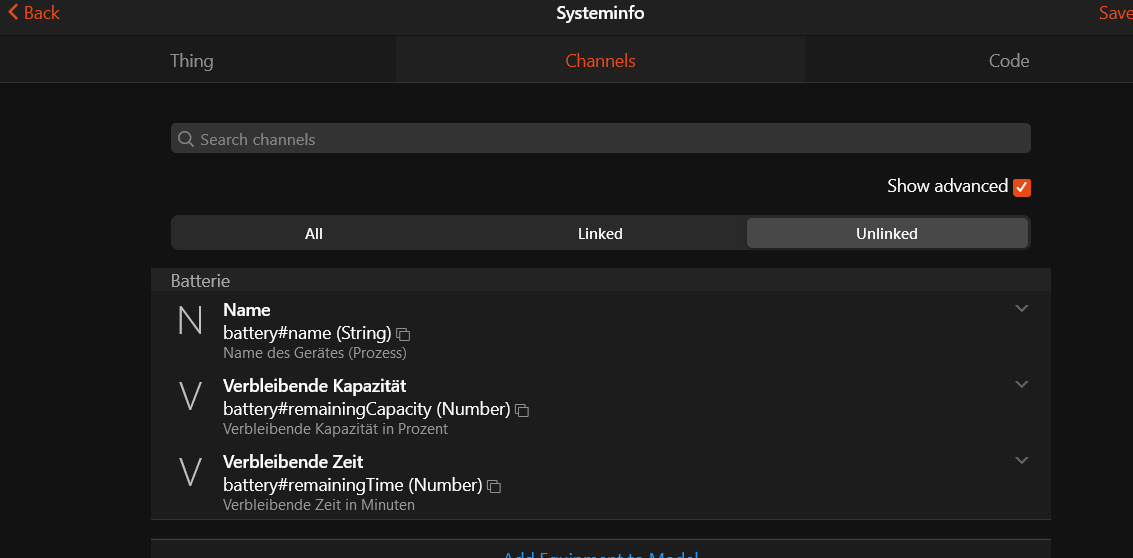

You have to unlink these channels and remove the items - then the error messages will be gone.
