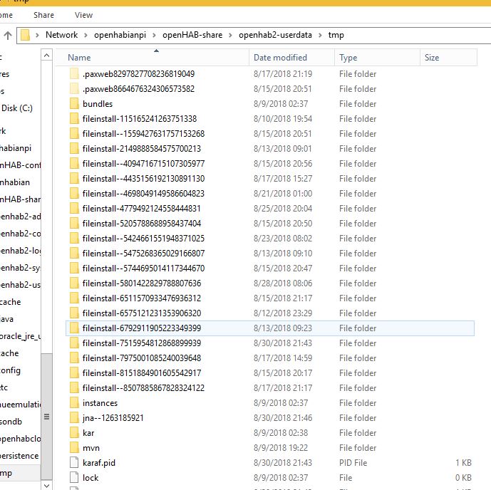

Now i reinstalled java, however I get the following error:
[01:14:21] openhabian@openHABianPi:~$ sudo /usr/share/openhab2/start.sh
Launching the openHAB runtime...
mkdir: cannot create directory ā€˜/usr/share/openhab2/userdata/tmp’: No such file or directory
KARAF_BASE is not valid: /usr/share/openhab2/userdata
what does this error mean?
My directory looks like this
Use sudo openhab-cli start to start a temporary instance of openHAB if you’re using openHABian or the apt packages. Calling start.sh directly expects the files to remain in one location.
That said, if JAVA was responsible for the outage, sudo systemctl start openhab2 should suffice now that it is fixed.
Thanks @Benjy,
I think the problem was not java in the end.
told me openhab was running under root and not as openhab user, and the error seemed like it were java, but I think it was just the fact that it was running under root.
This happened because I tried to restart openhab with an item:
Switch Div_Openhab {exec="ON:sudo systemctl restart opeanhab2.service"}
Maybe some of the maintainer can make a change to service so that it can not be started as root user…
sudo openhab-cli start will tell you which prosess to kill : sudo kill pid 520 if someone else experience the same issue.
So I still can not get Openhab to lunch with systemctl, so I guess its corrupted or something. I can not use sudo -openhab-cli start because then it shut down as soon as I close my laptop. So can I reinstall systemctl? Because the service file looks just like Rich pointed out:
