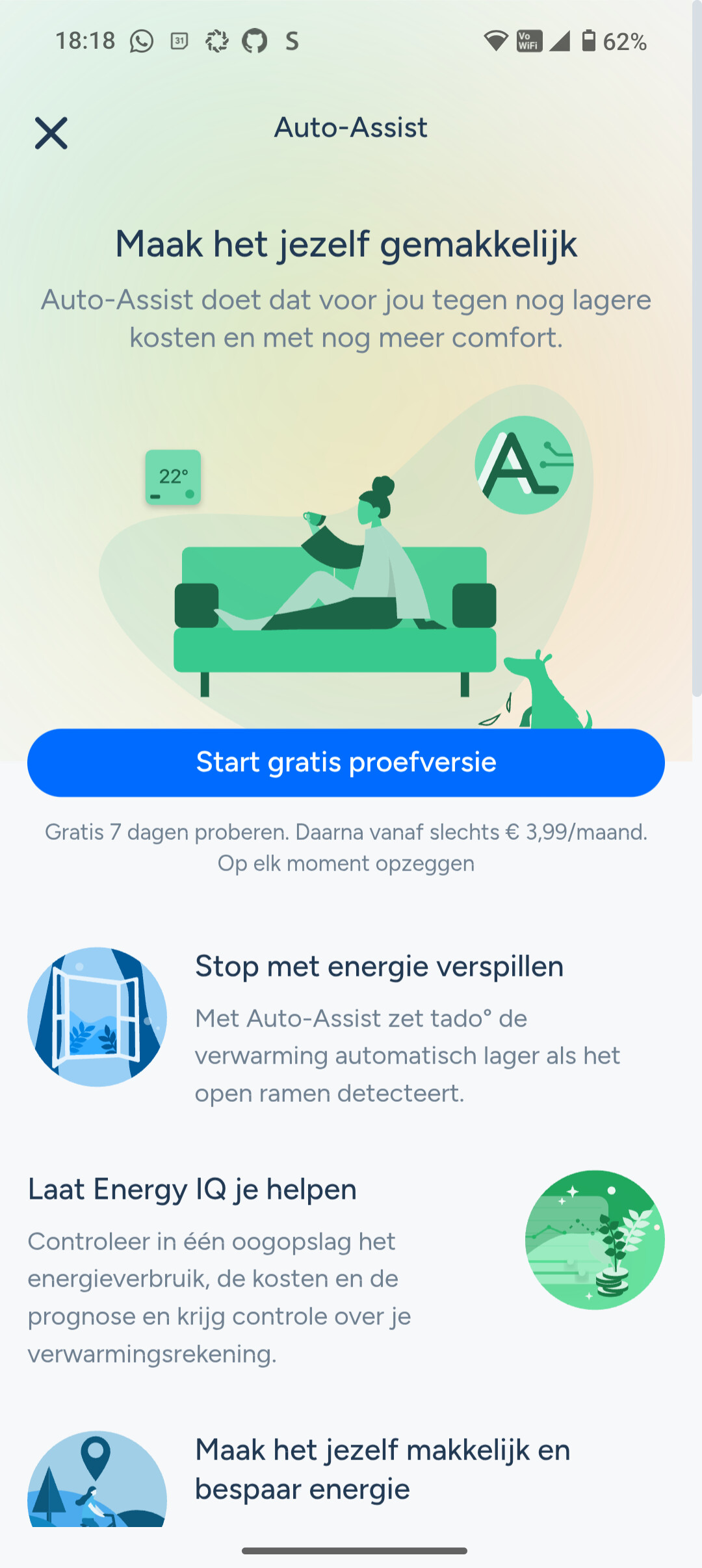

I just checked, that’s the exact same info I get. But in my tado Android app, ā€œAuto-Assistā€ is not included:
