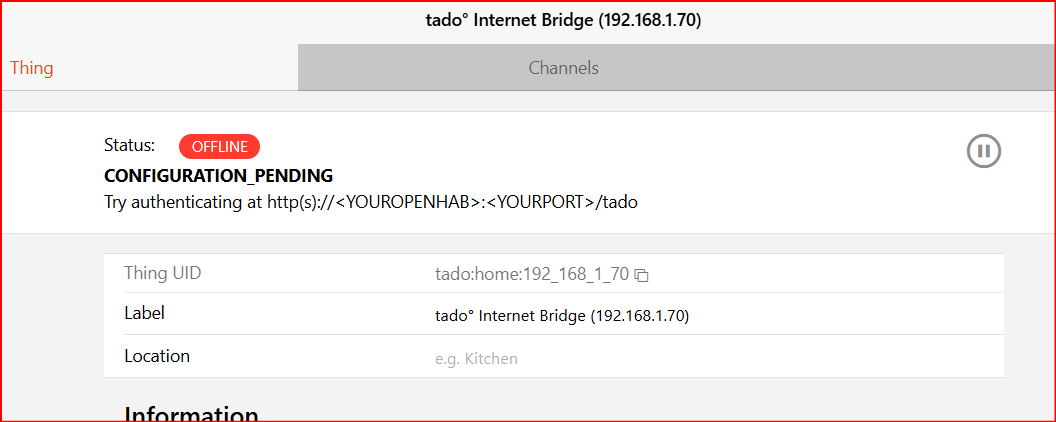

Indeed. So who knows if it might become so again? (But that is why that selection is hidden under Advanced Settings..)
Indeed. The binding provides the http(s)://<YOUROPENHAB>:<YOURPORT> placeholder and OH WebUI magically converts it to a real url at runtime :slight_smile: – however that feature is only in OH from v5.0.x so there is no magic applied in v4.3.4 :frowning:
https://github.com/openhab/openhab-webui/pull/2996
Aha. Then the problem will solve itself in a few months. :slight_smile:
Yes, you are right. At the website it is.
But I mean directly at the thing error messsage for better understanding, that it is not only a message from the system. It should be clearly understand, that it is a call for participation to the user.
I thought, that “Try authenticating at http(s):…” is only a message, not a todo for the user. :flushed_face:
In the Add-on Store under tado I didn’t found any hint in this direction, that there is anything else to do for authentification. Only username and password is required.
You are on v4.3.4 and the new documentation is not (yet?) backported into that. However when users migrate to v5.0.x the Add-on Store will pull in the new documentation.

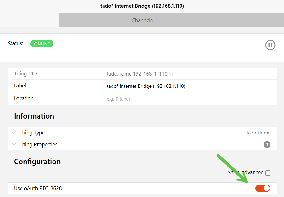

For anyone reading over this, to fix the error, I edited the following
/etc/openhab/services/runtime.cfg
I then commented out the lines under the ### WEBCLIENT ### heading:
I set the following values as a test:
org.openhab.webclient:minThreadsShared = 4
org.openhab.webclient:maxThreadsShared = 16
org.openhab.webclient:minThreadsCustom = 4
org.openhab.webclient:maxThreadsCustom = 16
Saved, and rebooted the VM and visited the URL again which now went through the oAuth procedure correctly and brought my bridge back online.

2025-04-05 00:24:41.569 [DEBUG] [ado.internal.handler.TadoZoneHandler] - Removing overlay of home 1375166 and zone 5
And then nothing.
http://192.168.1.9:8080/tado keeps loading, but no page is loaded. There’s also no logging of my attempt to load that page.
(This is all on OH 4.3.4)
I’ll now test your latest jar (https://github.com/openhab/openhab-addons/pull/18481), but I thought it might be worth sharing.
Do you have the useRFC-8628 config param set on?
Yes. The binding had also been operational for days…
