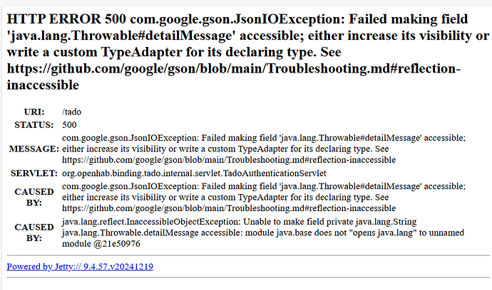

Tado authentication
2025-04-08 00:03:04.031 [WARN ] [org.eclipse.jetty.server.HttpChannel] - /tado
com.google.gson.JsonIOException: Failed making field 'java.lang.Throwable#detailMessage' accessible; either increase its visibility or write a custom TypeAdapter for its declaring type.
See https://github.com/google/gson/blob/main/Troubleshooting.md#reflection-inaccessible
	at com.google.gson.internal.reflect.ReflectionHelper.makeAccessible(ReflectionHelper.java:76) ~[?:?]
	at com.google.gson.internal.bind.ReflectiveTypeAdapterFactory.getBoundFields(ReflectiveTypeAdapterFactory.java:388) ~[?:?]
	at com.google.gson.internal.bind.ReflectiveTypeAdapterFactory.create(ReflectiveTypeAdapterFactory.java:161) ~[?:?]
	at com.google.gson.Gson.getAdapter(Gson.java:628) ~[?:?]
	at com.google.gson.Gson.fromJson(Gson.java:1360) ~[?:?]
	at com.google.gson.Gson.fromJson(Gson.java:1262) ~[?:?]
	at com.google.gson.Gson.fromJson(Gson.java:1171) ~[?:?]
	at com.google.gson.Gson.fromJson(Gson.java:1107) ~[?:?]
	at org.openhab.core.auth.oauth2client.internal.OAuthConnectorRFC8628.fetchAccessTokenResponse(OAuthConnectorRFC8628.java:358) ~[?:?]
	at org.openhab.core.auth.oauth2client.internal.OAuthConnectorRFC8628.getDeviceCodeResponse(OAuthConnectorRFC8628.java:204) ~[?:?]
	at org.openhab.core.auth.oauth2client.internal.OAuthClientServiceImpl.getDeviceCodeResponse(OAuthClientServiceImpl.java:476) ~[?:?]
	at org.openhab.binding.tado.internal.handler.TadoHandlerFactory.getDeviceCodeResponse(TadoHandlerFactory.java:223) ~[?:?]
	at org.openhab.binding.tado.internal.servlet.TadoAuthenticationServlet.serveUserAuthenticationPage(TadoAuthenticationServlet.java:148) ~[?:?]
	at org.openhab.binding.tado.internal.servlet.TadoAuthenticationServlet.doGet(TadoAuthenticationServlet.java:81) ~[?:?]
	at javax.servlet.http.HttpServlet.service(HttpServlet.java:497) ~[bundleFile:4.0.4]
	at javax.servlet.http.HttpServlet.service(HttpServlet.java:584) ~[bundleFile:4.0.4]
	at org.ops4j.pax.web.service.spi.servlet.OsgiInitializedServlet.service(OsgiInitializedServlet.java:102) ~[?:?]
	at org.eclipse.jetty.servlet.ServletHolder$NotAsync.service(ServletHolder.java:1450) ~[?:?]
	at org.eclipse.jetty.servlet.ServletHolder.handle(ServletHolder.java:799) ~[?:?]
	at org.eclipse.jetty.servlet.ServletHandler$ChainEnd.doFilter(ServletHandler.java:1656) ~[?:?]
	at org.ops4j.pax.web.service.spi.servlet.OsgiFilterChain.doFilter(OsgiFilterChain.java:113) ~[?:?]
	at org.ops4j.pax.web.service.jetty.internal.PaxWebServletHandler.doHandle(PaxWebServletHandler.java:334) ~[?:?]
	at org.eclipse.jetty.server.handler.ScopedHandler.handle(ScopedHandler.java:143) ~[?:?]
	at org.eclipse.jetty.security.SecurityHandler.handle(SecurityHandler.java:600) ~[?:?]
	at org.eclipse.jetty.server.handler.HandlerWrapper.handle(HandlerWrapper.java:127) ~[?:?]
	at org.eclipse.jetty.server.handler.ScopedHandler.nextHandle(ScopedHandler.java:235) ~[?:?]
	at org.eclipse.jetty.server.session.SessionHandler.doHandle(SessionHandler.java:1624) ~[?:?]
	at org.eclipse.jetty.server.handler.ScopedHandler.nextHandle(ScopedHandler.java:233) ~[?:?]
	at org.eclipse.jetty.server.handler.ContextHandler.doHandle(ContextHandler.java:1440) ~[?:?]
	at org.eclipse.jetty.server.handler.ScopedHandler.nextScope(ScopedHandler.java:188) ~[?:?]
	at org.eclipse.jetty.servlet.ServletHandler.doScope(ServletHandler.java:505) ~[?:?]
	at org.eclipse.jetty.server.session.SessionHandler.doScope(SessionHandler.java:1594) ~[?:?]
	at org.eclipse.jetty.server.handler.ScopedHandler.nextScope(ScopedHandler.java:186) ~[?:?]
	at org.eclipse.jetty.server.handler.ContextHandler.doScope(ContextHandler.java:1355) ~[?:?]
	at org.eclipse.jetty.server.handler.ScopedHandler.handle(ScopedHandler.java:141) ~[?:?]

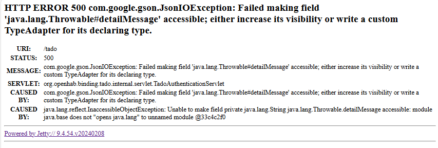

2025-04-08 12:09:31.851 [WARN ] [org.eclipse.jetty.server.HttpChannel] - /tado

Caused by: java.lang.reflect.InaccessibleObjectException: Unable to make field private java.lang.String java.lang.Throwable.detailMessage accessible: module java.base does not "opens java.lang" to unnamed module @1a243b32
	at java.lang.reflect.AccessibleObject.throwInaccessibleObjectException(AccessibleObject.java:391) ~[?:?]
	at java.lang.reflect.AccessibleObject.checkCanSetAccessible(AccessibleObject.java:367) ~[?:?]
	at java.lang.reflect.AccessibleObject.checkCanSetAccessible(AccessibleObject.java:315) ~[?:?]
	at java.lang.reflect.Field.checkCanSetAccessible(Field.java:183) ~[?:?]
	at java.lang.reflect.Field.setAccessible(Field.java:177) ~[?:?]
	at com.google.gson.internal.reflect.ReflectionHelper.makeAccessible(ReflectionHelper.java:68) ~[?:?]

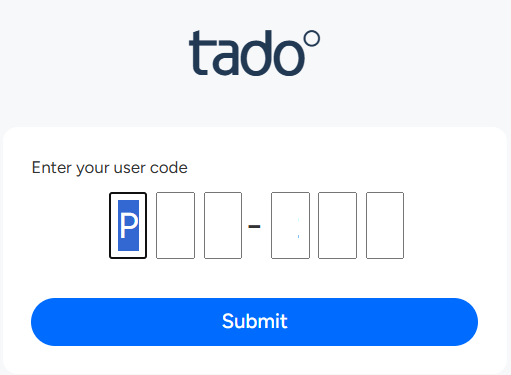

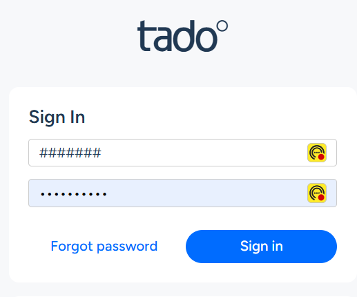

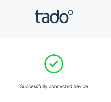

The sequence of screens that you should see is as follows..

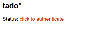

OpenHAB Servlet
Tado Enter User Code Page
Tado Signin Page
Tado Success Page

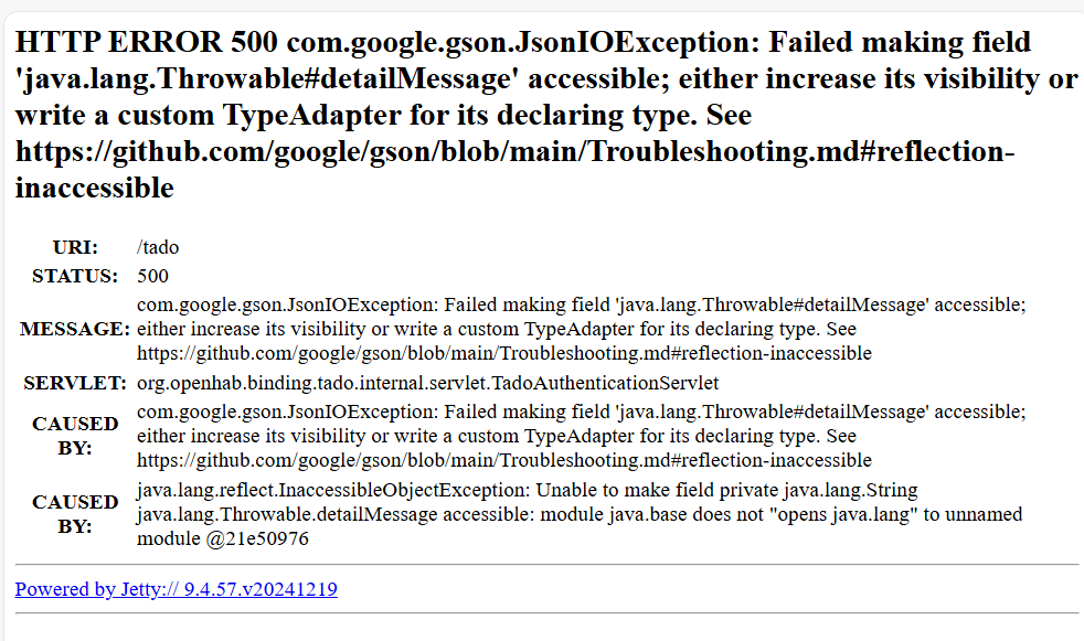

I can’t reach the page with submit button (Tado User Code Page) , when I click on “click to authenticate” in the Openhab Servlet page the browser give me the error below
As mentioned above, your refresh token is trashed, so you need to manually edit the storage json file and remove the tado.home entries.
When you have deleted all tado.home entries, then turn on log:set TRACE org.openhab.core.auth please. The HTTP 500 error does not help me.
After I deleted all tado:home entries in StorageHandler.For.OAuthClientService.json :

I finally solved the error below
I add this string set.JDK_JAVA_OPTIONS=–add-opens=java.base/java.lang=ALL-UNNAMED in the openhab-wrapper.conf file as here :
# openHAB-wrapper.conf for Windows Service Installation
# openHAB installation dir (Adapt this first setting to your system)
set.default.OPENHAB_HOME=C:\openHAB
set.JDK_JAVA_OPTIONS=--add-opens=java.base/java.lang=ALL-UNNAMED
# Wrapper Properties
@andrea636 many thanks for the log.
It shows the start of a normal authentication process. Your system is fetching a user code and a device code with a validity of 300 seconds, and a polling interval of 5 seconds. It does the first poll, which returns correctly a pending error, and the servlet would then forward you to the Tado login page. But the issue is that the GSON parser on your system fails to parse the pending error and instead throws the exception that you posted previously. And this kills the rest of the login process.
So the issue is the GSON parser failing.
The strange thing is that I have tested this on my operative OH systems on v4.3.x and v5.x both on Linux and Windows and both with Java 17 and 21, on three different machines, and in none of those cases does the GSON parser throw this error. However I did manage to set up a rudimentary Junit test in Eclipse where I could force such a GSON parse error. But honestly I have no idea why there is this variability.
The actual GSON error stems from Java Reflection being unable to access a particular unused private data field, so it may perhaps be something to do with the flavour of Java that you are running on, and/or your runtime environment.
Anyway the conclusion is that I have made some changes in OH core with a custom parser for the error messages, that should avoid the GSON Reflection error. This has been merged into OH core where it will appear in the next OH v5.x Snaphot and possibly eventually in a next v4.3.5 patch, but I have no idea of the OH release cycle for the latter.
EDIT: my message crossed with yours above. And it confirms that there is some oddity in the JRE .. so as a matter of interest perhaps you can explain why that option would have fixed this issue? It beats me..
I don’t know how this string in the wrapper.conf fix the problem. I searched for a solution on many sites and i when I saw these two I try ..
Firts site/blog
Second site/blog
After reading these two sites I only tried with the string set.JDK_JAVA_OPTIONS=–add-opens=java.base/java.lang=ALL-UNNAMED
The issue concerns deep reflection. The OH OAuth error class is a descendent of the Throwable class which is within the Java core. When GSON deserializes an error message it uses reflection to set the class field. And since the class is a descendent of Java core that requires deep reflection. Prior to Java v9 deep reflection was perfectly Ok. But thereafter – on some installations – it was forbidden. This means that the bug has been present and undiscovered since Java 9, and you seem to be the unlucky one whose installation forbids deep reflection. But the good news is that we have now two solutions – namely your option setting that reenables deep reflection on your system, and my solution in Java code that instantiates the error class object by a means that does not require deep reflection.
I also had issues with stopping bindings every few hours. I copied you latest jar file and everything works fine again since the last 2 days. Thank you very much for you effort @AndrewFG !
I received the same message after restoring Openhab on another device from a backup.
Deleting the complete entry for “tado:home.AccessTorkenResponse”: …}” in \OPENHABIAN\openHAB-userdata\jsondb\StorageHandler.For.OAuthClientService.json solved the problem for me as well.
This solves the problem for me. Seems that there were broken/outdated tokens in the json file. Just kicked out every key with “tado:home”, restarted openhab and went to /tado to authenticate.
