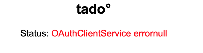

Hi
i had to reinstall my oh with an old backup.
Now i see that i can’t use my todo addon.
I got this error message OAuthClientService errornull.
How can i fix it?

Then i also open the authenicatino process again http://oh-ip-address:8080/tado but still the same problem as you can see in my screenshot.
