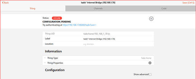

my tado bridge thing went offline yesterday evening. Testing the authentication with http(s)://:/tado I still get: “Status: authenicated”
Cancelling and rediscovering of the bridge didn’t help. Neither restarting OH. I am running version 4.3.5. Any hints what I can do?

I disabled my tado:home thing, and then re-enabled it. In the “normal” logs, this was the output:
10:02:48.637 [INFO ] [hab.event.ThingStatusInfoChangedEvent] - Thing 'tado:home:192_168_1_70' changed from UNINITIALIZED to UNINITIALIZED (DISABLED)
10:02:53.663 [INFO ] [hab.event.ThingStatusInfoChangedEvent] - Thing 'tado:home:192_168_1_70' changed from UNINITIALIZED (DISABLED) to INITIALIZING
10:02:53.714 [INFO ] [hab.event.ThingStatusInfoChangedEvent] - Thing 'tado:home:192_168_1_70' changed from INITIALIZING to OFFLINE (CONFIGURATION_PENDING): Try authenticating at http(s)://<YOUROPENHAB>:<YOURPORT>/tado?user=

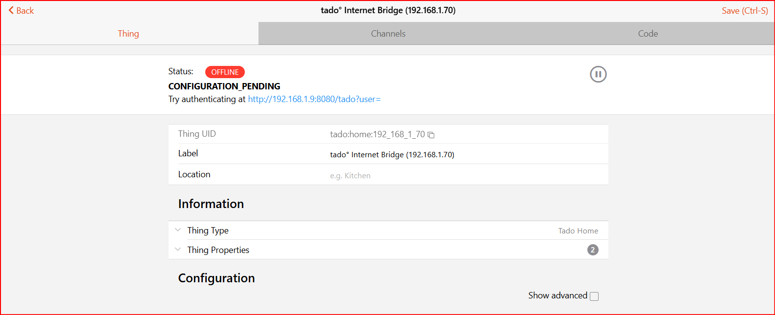

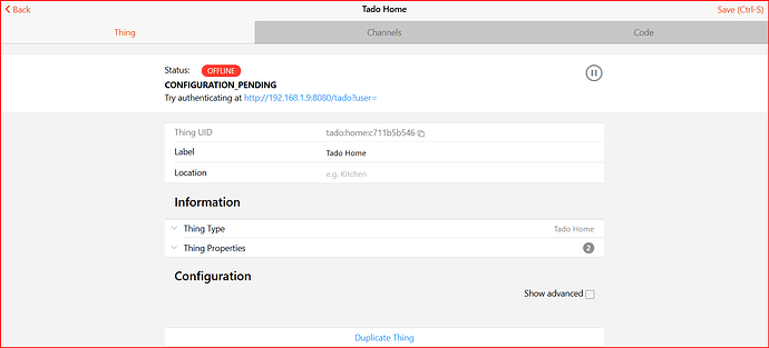

PS: For some reason, I have two tado:home things:
Tado was the first thing I ever installed, so I didn’t know what I was doing at the time. But I still don’t understand how this is possible (and workable)… Should I delete one of both tado:home things?

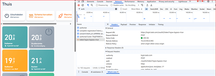

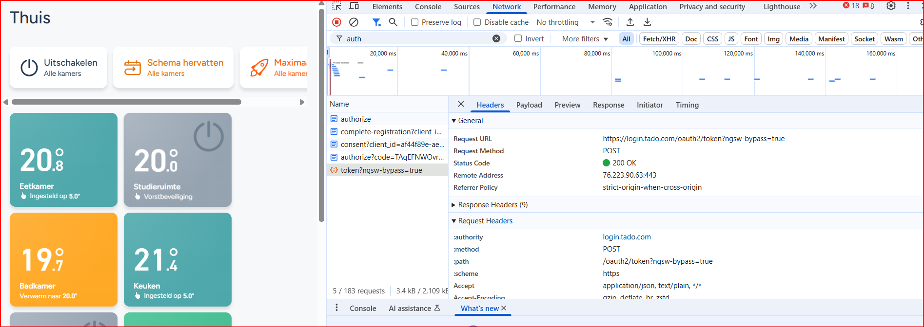

Anyway, if I log in via the site, I see this:
Copied for cURL (bash), that gives:

The response (copied from Chromes console) is this:
    "access_token": "[thisisprobablysensitive]",
    "expires_in": 599,
    "refresh_token": "[thisisprobablysensitive]",
    "refresh_token_id": "[thisisprobablysensitive]",
    "scope": "home.user offline_access",
    "token_type": "Bearer",
    "userId": "[thismightbesensitive]"
Maybe that refresh_token is something worthwhile?
But it (of course) seems more complicated than that: Upcoming changes to the tado° API · Issue #151223 · home-assistant/core · GitHub & Upcoming changes to the tado° API · Issue #151223 · home-assistant/core · GitHub.

I know, but the web app doesn’t respond 429; it responds 200. That means that it authenticates ‘differently’. Maybe its refresh token might give us the possibility to log in in a way that tado thinks the HTTP calls come from its web app. And then there is no 100 call limit.
