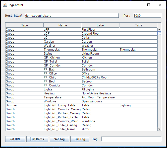

As going on with my own openhab integration i was too lazy to set and modify the tags over the REST API Documentation on the openhab Web-UI, so i was looking for a simplier alternative.
So i spent some time to code a nice and simple Java program, which gives you basic functionality and is also just as simple to use as making 3 clicks.
Intorducing “Tag Control”: https://drive.google.com/file/d/1Z6UhYkqsOpni2B9x06qD1PRwoQGogwAY/view?usp=sharing
Some notes on this:
  • limited to 1500 items
  • limited to the first tag only per item (but still several tags can be set and deleted)
  • starting with linked openhab demo for testing purposes
  • requires installed java
As told, it provides only basic functionality to be as simple and quick to use as possible.
  1. put in your openhab url and port in the header
  2. click “set url”
  3. click “get items” and you see all items provided by your openhab
  4. select an item you want to edit in the table (just by one-clikcing on it. do not doubleclick and edit anything, even it is possible so far. This would (or should) have no effect on the tag assignment, but may cause problems)
  5. enter a tag at the bottom
  6. set or delete the entered tag, as you want, by clikcing the corresponding button.
  7. repeat 4. - 6. for all items you want to tag / untag.

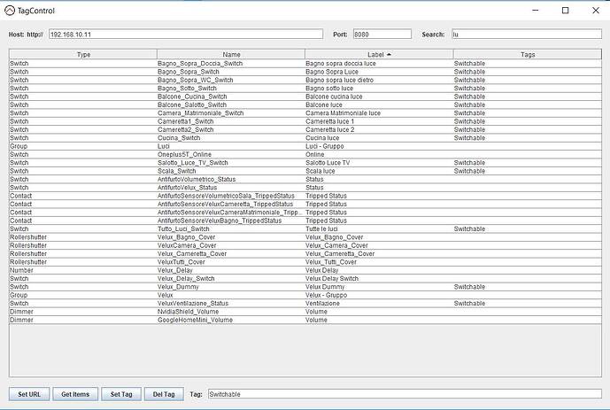

Hi, I created a modified version with sorting and filtering because I needed them starting from your program!
Can I share the jar on the forum?

Of course you’re free to edit and publish varieties of it.
Still, i tried to get your version to running, @Riccardo_Garofano, but it did not start for me.
So i digged out my old code (which i still will publish on git asap) and did some modification.
The tag editor runs on 2.4 fine. It was just forbidden to “get items” from the demo OH, as they increased to like 1750 and my software was developed to handle 1500 at max. So it just crashed in the background, but the GUI was still responding.
I increased the max items to 3000 now, inserted sorting function, made the shown table not editable (just to prevent other errors) and did a bit of background coding. Also there is a little dirty debug window now. It’s hidden and you can bring it up, by clicking on the mysterious little square on the bottom right corner.
It’s ment to be used only when you get serious errors. Better not play around with this :wink:
I did not that much of testing as i lack on time, but i fixed the new coded errors as i found by basic testing. When you get even more ideas or problems, tell me and ill try to fix.
So far: here we go for version 1.1 :partying_face:
