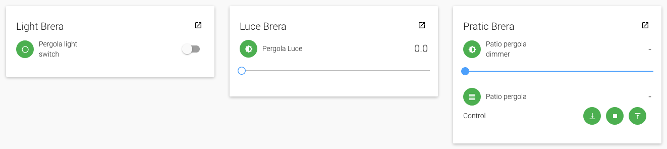

I can turn on and off the lights, but there’s no way to dim them. This is what I get on the UI
Can anyone shed some “light” :slight_smile:

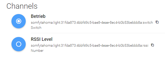

There are two channels in my thing
  • switch
  • rssi
Can someone confirm that?

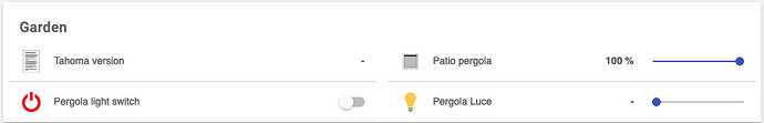

Thanks for prompt reply! I’ve created the sitemap, but the outcome doesn’t change. I can turn on and off the light but still it can’t be dimmed, the values are completely ignored. This is what I have on the log file:
020-08-18 18:41:36.512 [vent.ItemStateChangedEvent] - PergolaLightSwitch changed from OFF to ON
2020-08-18 18:41:39.398 [ome.event.ItemCommandEvent] - Item 'PergolaLuce' received command 45
2020-08-18 18:41:39.402 [nt.ItemStatePredictedEvent] - PergolaLuce predicted to become NULL
2020-08-18 18:41:44.889 [ome.event.ItemCommandEvent] - Item 'PergolaLuce' received command 74
2020-08-18 18:41:44.895 [nt.ItemStatePredictedEvent] - PergolaLuce predicted to become NULL
2020-08-18 18:42:08.354 [ome.event.ItemCommandEvent] - Item 'PergolaLuce' received command 9
2020-08-18 18:42:08.360 [nt.ItemStatePredictedEvent] - PergolaLuce predicted to become NULL

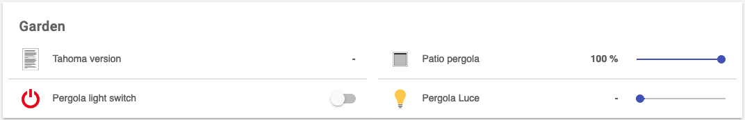

and the rendered sitemap:
Any other glue?
