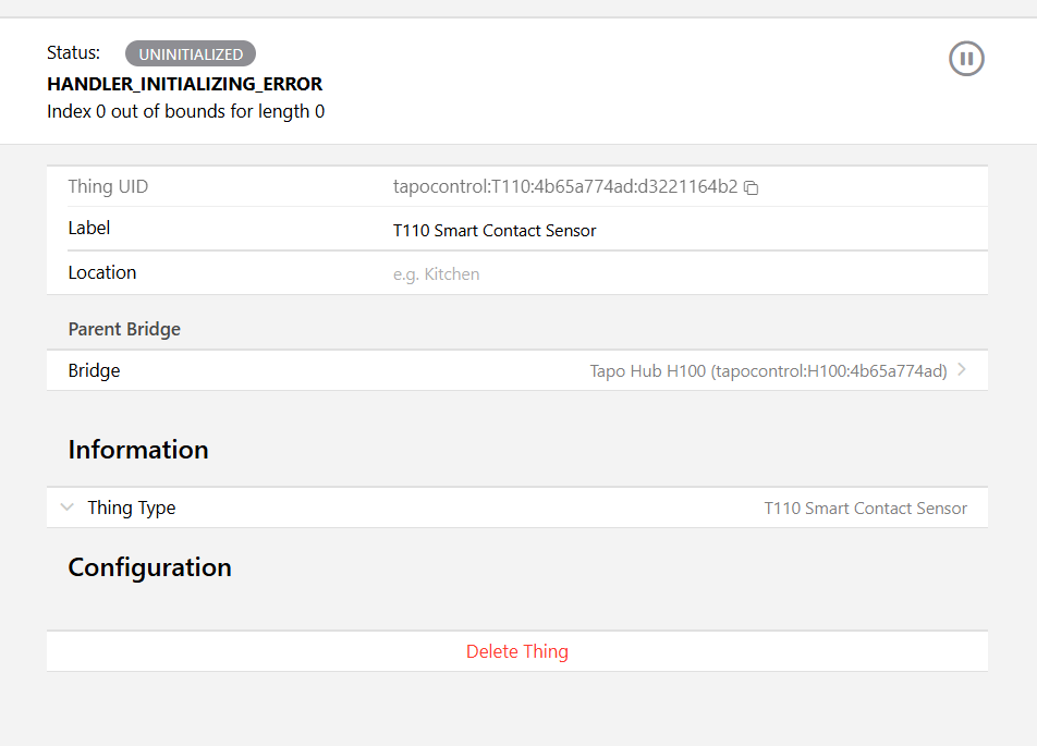

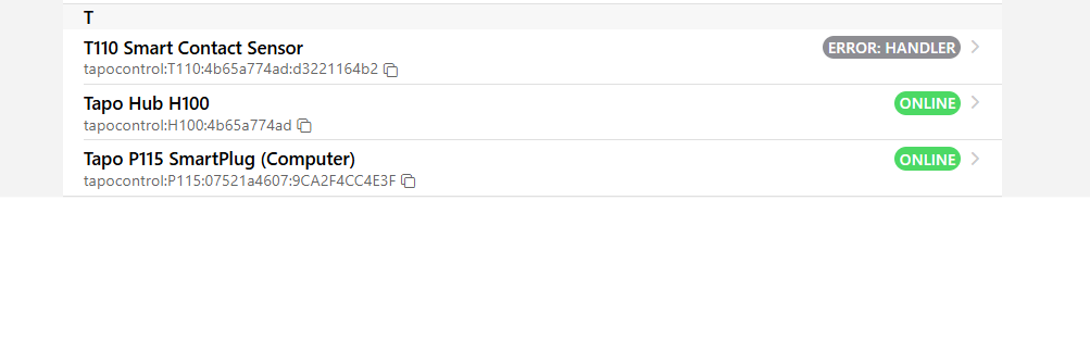

I try to integrate a Tapo window sensor T110 into my system but I get an initialization error as shown in the title. The Hub is initialiezed correct, as well as the Cloud Login Bridge.
The configuration pa
ge looks like that:
