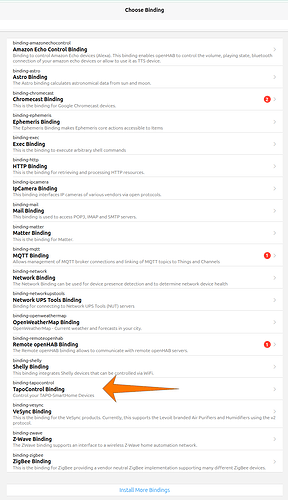

I have two Raspi Pi 4s, one running OH 4.3.3 and the other running OH 5.0.1. I have installed the TapoControl Binding as well as the TP-Link Smart Home Binding on both.
On the OH4 box I have a “Cloud-Login” thing but it is not present on the OH5 box so I am unable to configure the bridge.
What do I need to do to get the Cloud-Login to show on the OH5 box?

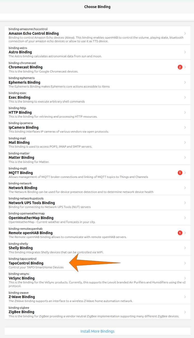

The problem is that there is no bridge thing (Cloud-Login) to click on for the OH5 machine. Your procedure works as expected on the OH4 box. I recall struggling to get it working, but took no notes.

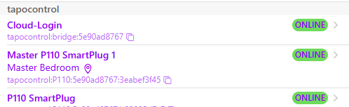

OH4 machine:

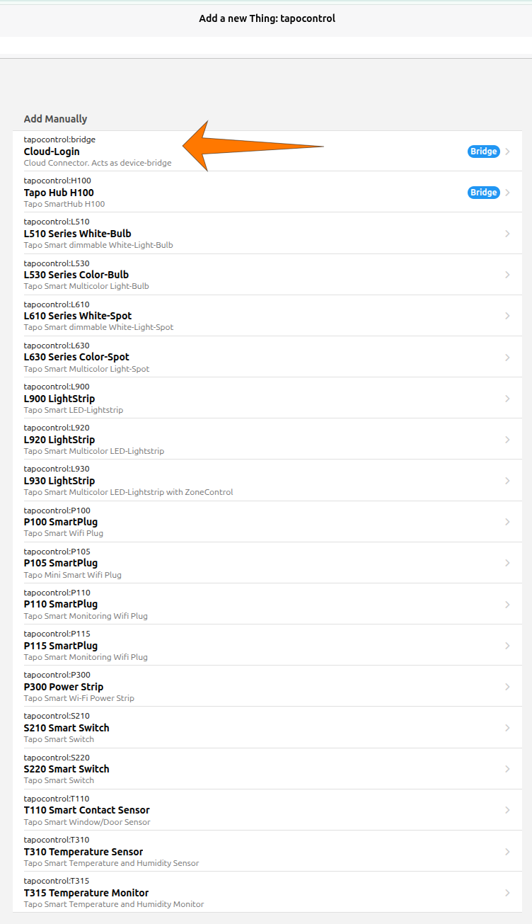

If you’ve not manually created the bridge Thing, there won’t be one to click on from MainUI → Settings → Things.
You have to manually configure it.

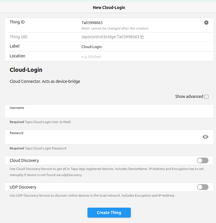

MainUI → Settings → Things → +
Then select “Cloud Login”

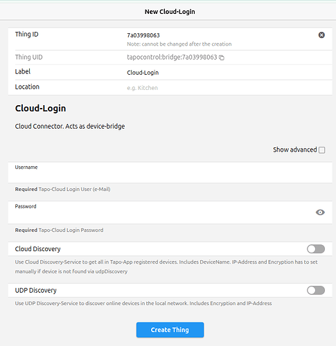

Fill out all the relevant information and click “Create Thing”
Only after doing that will you have a Cloud-Login Thing listed under MainUi → Settings → Things. It’s not created nor discovered automatically.
That was it! Thank you again!
I guess it should have been obvious but for me it wasn’t. Initially I got a conflict error but after changing the UID slightly the bridge came online.
