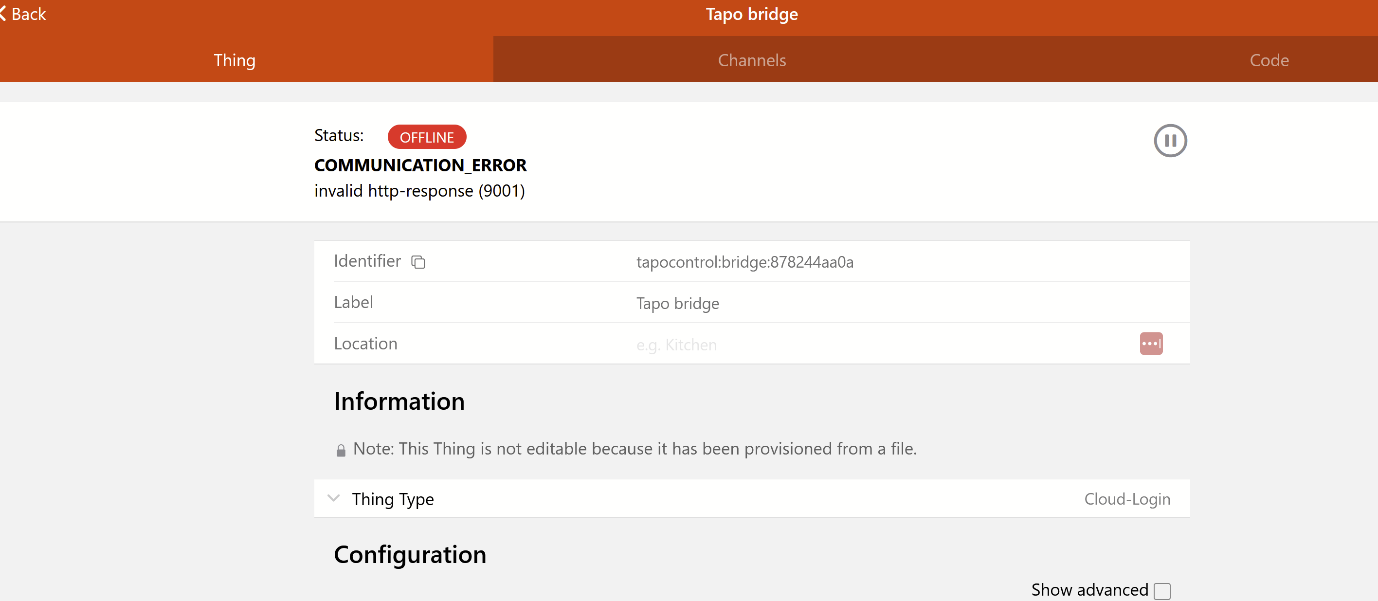

I’ve just set up a fresh installation of OpenHAB 4.1.3 on a Raspberry Pi and I’m trying to integrate a Tapocontrol device. However, I’m encountering a communication error:
COMMUNICATION_ERROR
invalid http-response (9001)

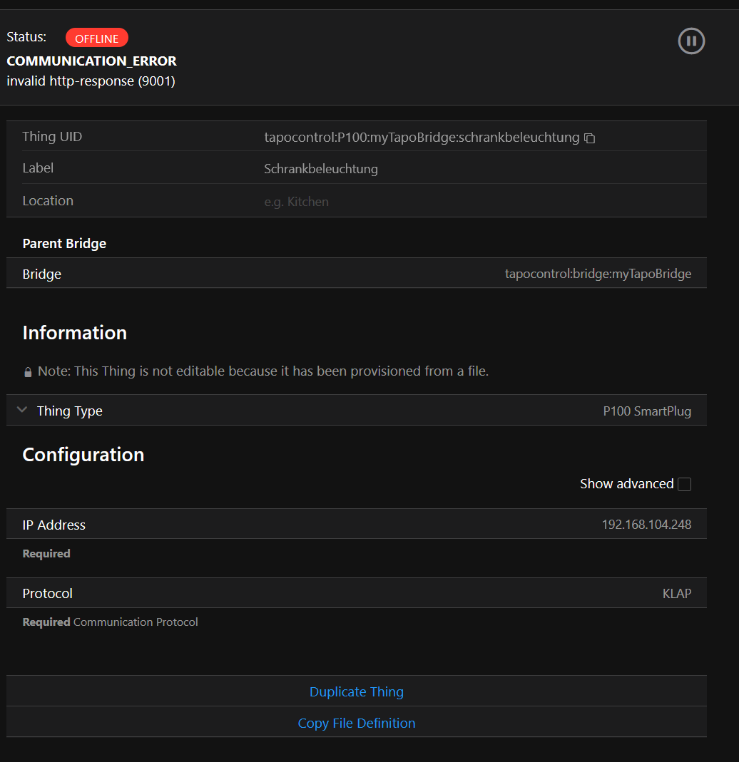

Hi, I have now with 5.02 the same problem with my P100, do you have an idea? (was fully functional some weeks ago..), two devices and same problem.

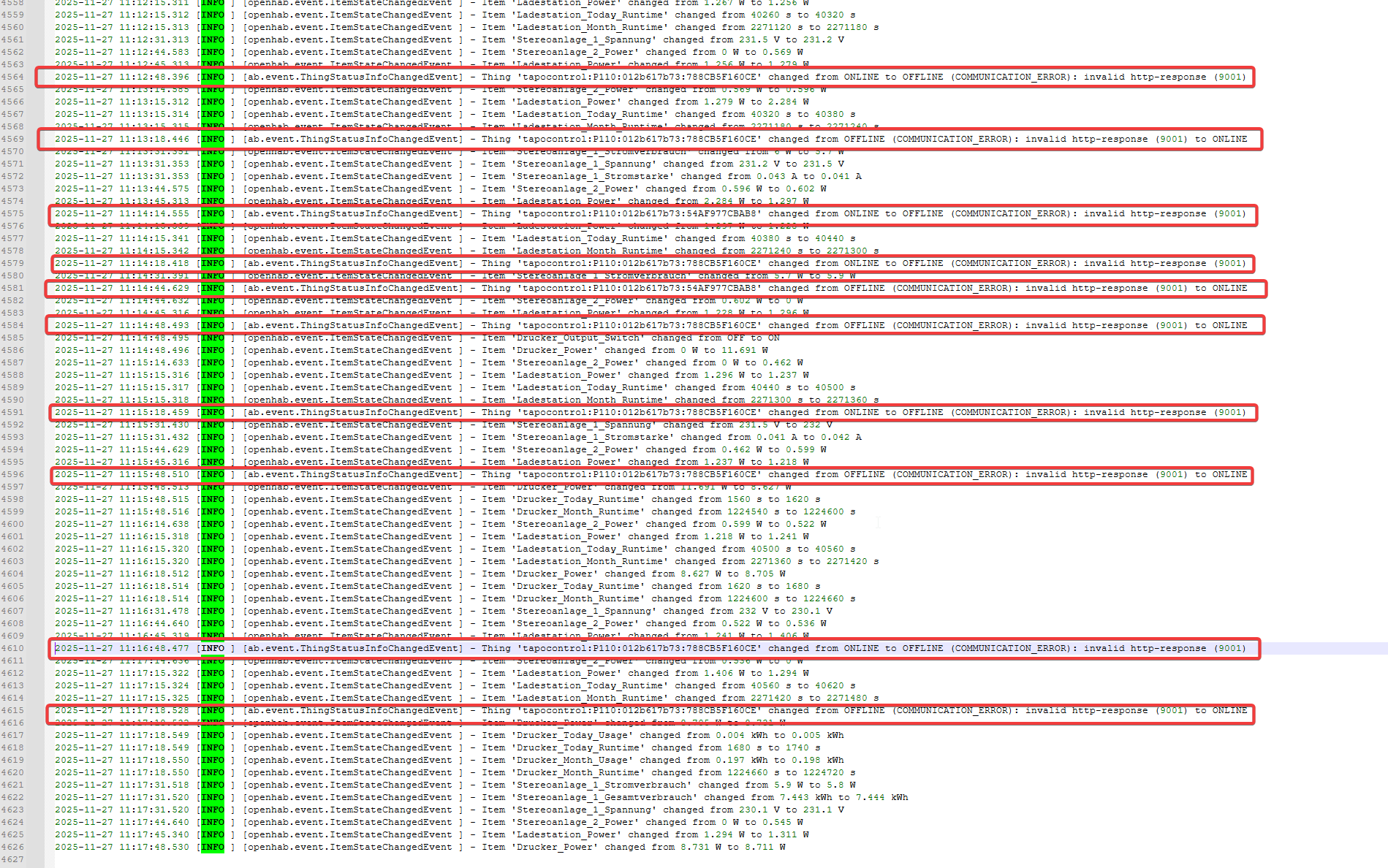

for me it is not a stable solution. The state of the plug (P110) switches back and forth between green and red.
Can anyone confirm that he also sees this behaviour? This leads to a behaviour where sometimes the command (switch on) is not executed, whiile a second later it works.

I can agree, I have enabled third party in the Tapo App. The P110 power outlet is switching between online and after a some minutes to offline. Then online again and so on. It’s a new P110 Plug with firmware 1.4.0
I can’t observe this with an older power outlet running firmware 1.3.1; it seems to work there.
