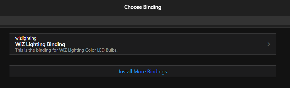

Hello.
I have downloaded the jar but it is not showing in the ui bindings list. These are the addons that I have:
pi@pi4:/usr/share/openhab/addons $ ls -lh
total 234M
-rw-r--r-- 1 openhab openhab 233M Sep  8 06:41 openhab-addons-3.2.0-SNAPSHOT.kar
-rw-r--r-- 1 root    root    130K Sep  8 13:53 org.openhab.binding.tapocontrol-3.2.0-SNAPSHOT.jar
-rw-r--r-- 1 root    root     67K Jan  1  2021 org.openhab.binding.wizlighting-3.0.0-SNAPSHOT.jar
-rw-r--r-- 1 openhab openhab   70 Sep  8 06:41 README
It is odd because the wizlighting binding appears with no problem:
Can you please help? I really would like to see my bulbs working with Openhab.
Pedro
When you add a new thing it will appear and, before adding a thing, you should fill your Tapo credentials.
Hello Hugo. Thank you for your answer.

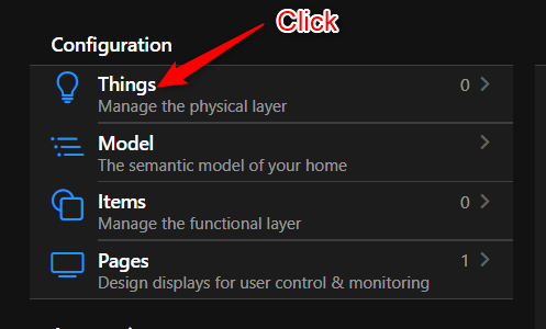

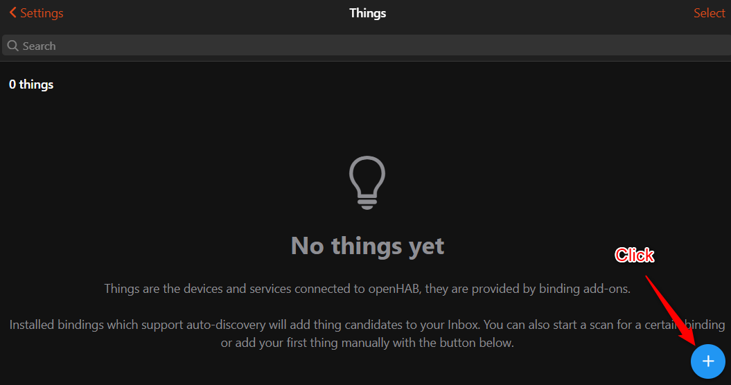

The sequence of actions is not clear for me. This is what I am doing:
then:
