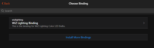

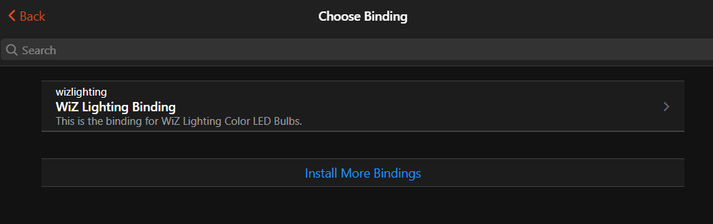

And now I’m at this screen:
2021-09-08_15h06_34
What should I do next?
Thanks :slight_smile:
I’m having the same issue now.
The binding appeared once after having downloaded it. Had to remove it from the addons directory and now it is no longer installing. Restart of OH doesn’t work either.
I will play around with it to see if I can find something.
