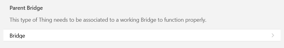

Thanks for this new version. I have 4x P100 and only two were added to inbox. These 2 are working but let’s wait some time to see if they do experience delay problems like in previous versions.
The other 2 were not in the inbox and when I try to add them manually there is no place I can specify the bridge, so they do not work.
The new definition process is a bit confusing. 1st discovery, 2nd manual IP edit. Can this be simplified ?

After updating to 1.4.9 exactly the same symptom. The binding only finds the same 2 P100’s and the other 2:
Let me try to give an example of what manual add device could be. I use the Unifi binding and when I add a device, besides having to specify its IP or MAC address, I must also specify the bridge
Edit: I’m using the UI to add things & items. Shall I use conf folder instead ?

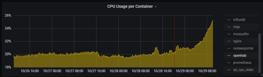

It seems I have the same issue, installed it around 20:45 (red line) and as you can see moments after that my CPU starts to rise.
Will keep you posted, however this is not looking good at the moment
I cannot retrace that. My CPU-Load is in Idle all time.
How many tapo-devices have you connected. Have you added rules or something to your items? Wich openhab version are you running?
In my case it’s running ok. No extra CPU, no extra RAM. I have a zigbee button controlling two lights in the same room, one zigbee and another connected to a Tapo P100. An early symptom of problems was the P100 light switching after the zigbee one (and increasing this delay over time), but now the P100 light is switching before the zigbee one (by a fraction of a second), which is a very good sign.
OH3.2.0.M3 running in QNAP, X86_64 platform, ZULU JDK11
