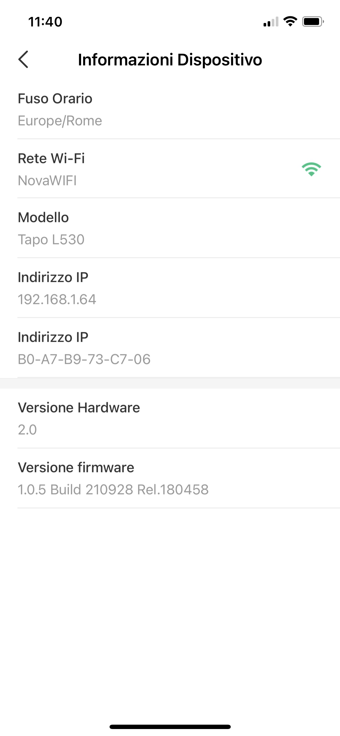

Hi Trying to use TAPO 3.2 Bindings on OH 3.1 Raspberry PI I can’t configure L530E Bulb. First of all it isn’t added automatically, OH3 never found it.
I connect right to TAPO cloud login but as i try to make an L530 THING I got:
Status:
OFFLINE
CONFIGURATION_ERROR
found type:‘L530’ with mac:‘B0-A7-B9-73-C7-06’. Check IP-Address
Any Help Appreciated.
Cheers, Eriberto
@Eriberto_de_Munari
Normally the 530 returns his type as " L530E Series".
Looks like you’re device is responding just as L530. Is it a non EU-Version or a special Firmware?
Maybe you can Post a Screenshot of DeviceInfos from your Tapo App
