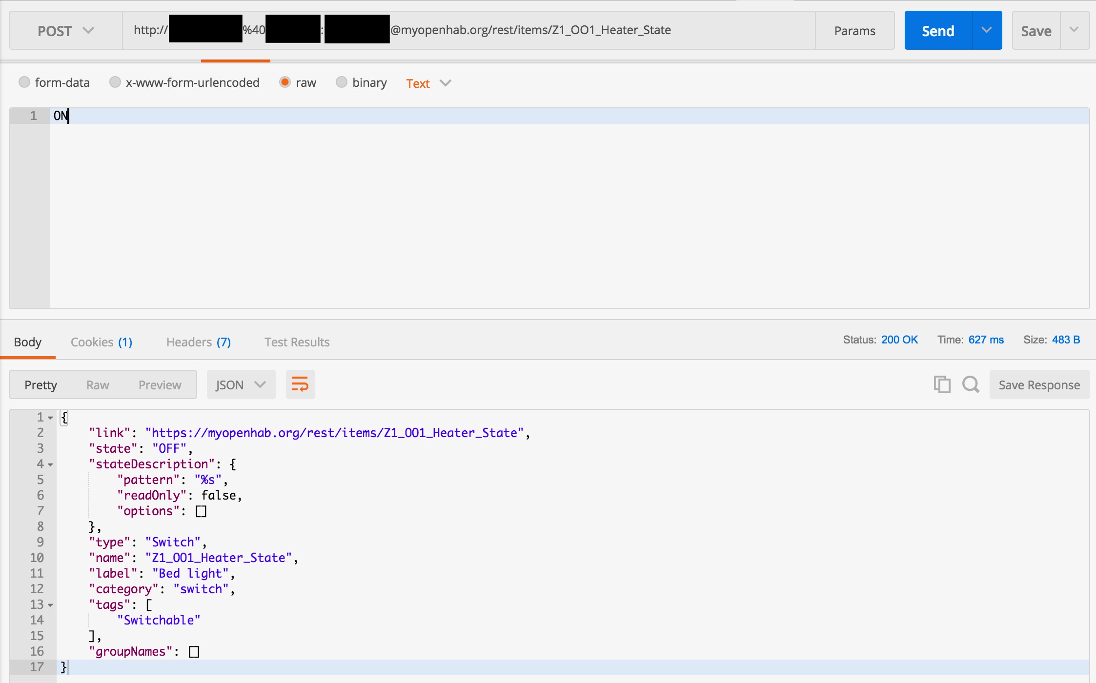

Did you also try a POST to toggle a light for example?
I use Postman to send a HTTP POST request but I only get this back without an update of my item:
    "link": "https://myopenhab.org/rest/items/Z1_OO1_Heater_State",
    "state": "OFF",
    "stateDescription": {
        "pattern": "%s",
        "readOnly": false,
        "options": []
    "type": "Switch",
    "name": "Z1_OO1_Heater_State",
    "label": "Bed light",
    "category": "switch",
    "tags": [
        "Switchable"
    "groupNames": []
When I send the same plain\text command “ON” to the local url “http://IP_ADDRESS:8080/rest/items/Z1_OO1_Heater_State” this works perfectly. Can someone tell me why and how to fix it?

I did use this basic auth as you mentioned. But the response with is just:
    "state": "OFF",
        "pattern": "%s",
        "readOnly": false,
        "options": []
    "type": "Switch",
    "tags": [
        "Switchable"
    "groupNames": []
My content-type is text/plain and the body is ON. I tried to point out that it works like this with the local url but that I cannot get it working with the myopenhab url. Do you have any idea why?
Are you certain this is a POST? When I do a POST to command an item the response body is empty. That looks like a GET response body.
33
Can you bring up the REST API Docs through myopenhab.org and make the call through the Docs?
You just made me solve my own question, thank you Rich!
The solution:
https://mail%40mail.be:password@home.myopenhab.org/rest/items/Z1_OO1_Heater_State
I had to use home.myopenhab.org and HTTPS instead of HTTP.
