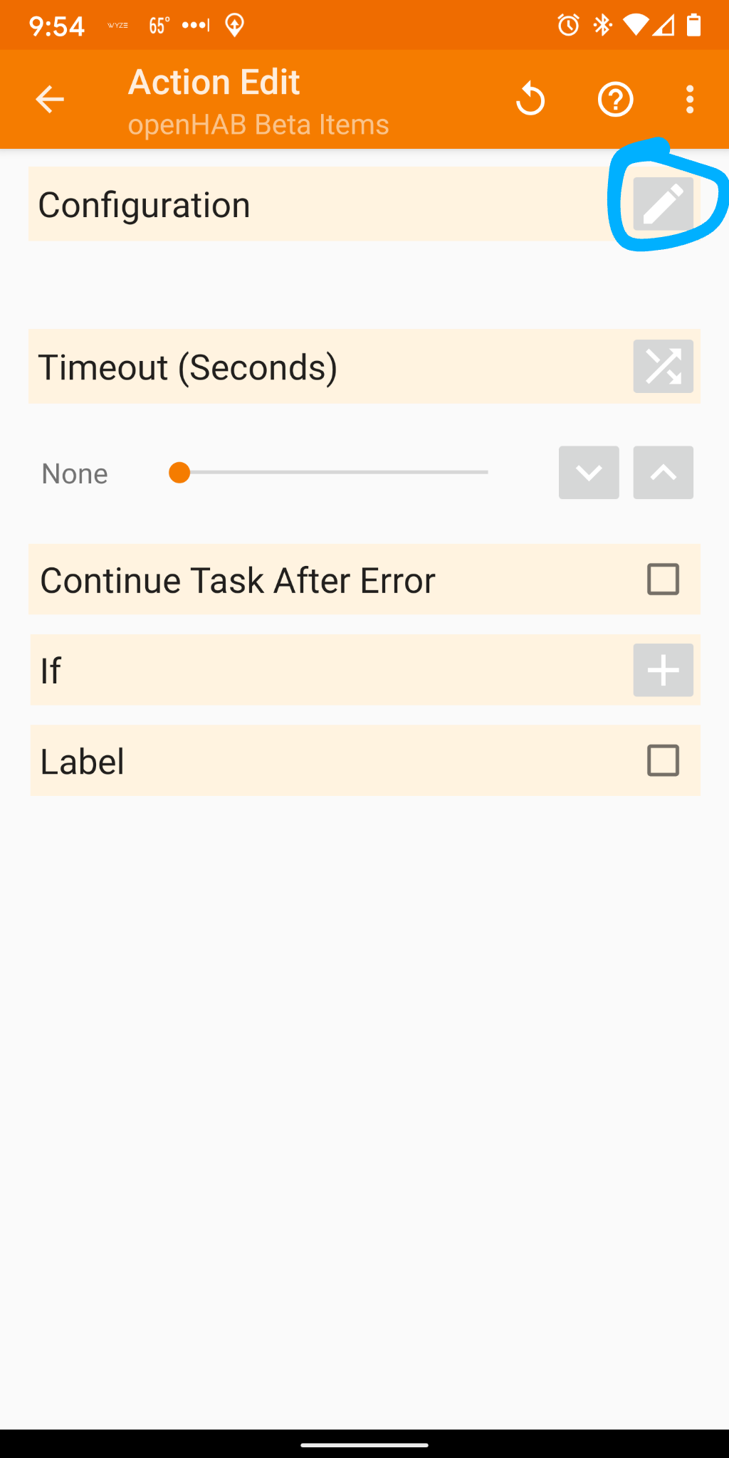

Choose openHAB from the list (I’m running the beta version of the app).
This will open the configuration screen. Tap the pencil icon next to “Configuration”.
Make sure that “Command” is selected at the top and scroll down to the Item you want to control. Tap it and select the command you want to send. I this case I selected aGarageOpener1 and chose “ON” as the command.
Set a reasonable timeout and check the box next to “Continue Task After Error”. Also take note of the little note that was added under Configuration. The HTTP return code will be saved to a variable called %httpcode. We will use that to generate an error message if the command failed.
Tap the arrow at the top to save the changes.

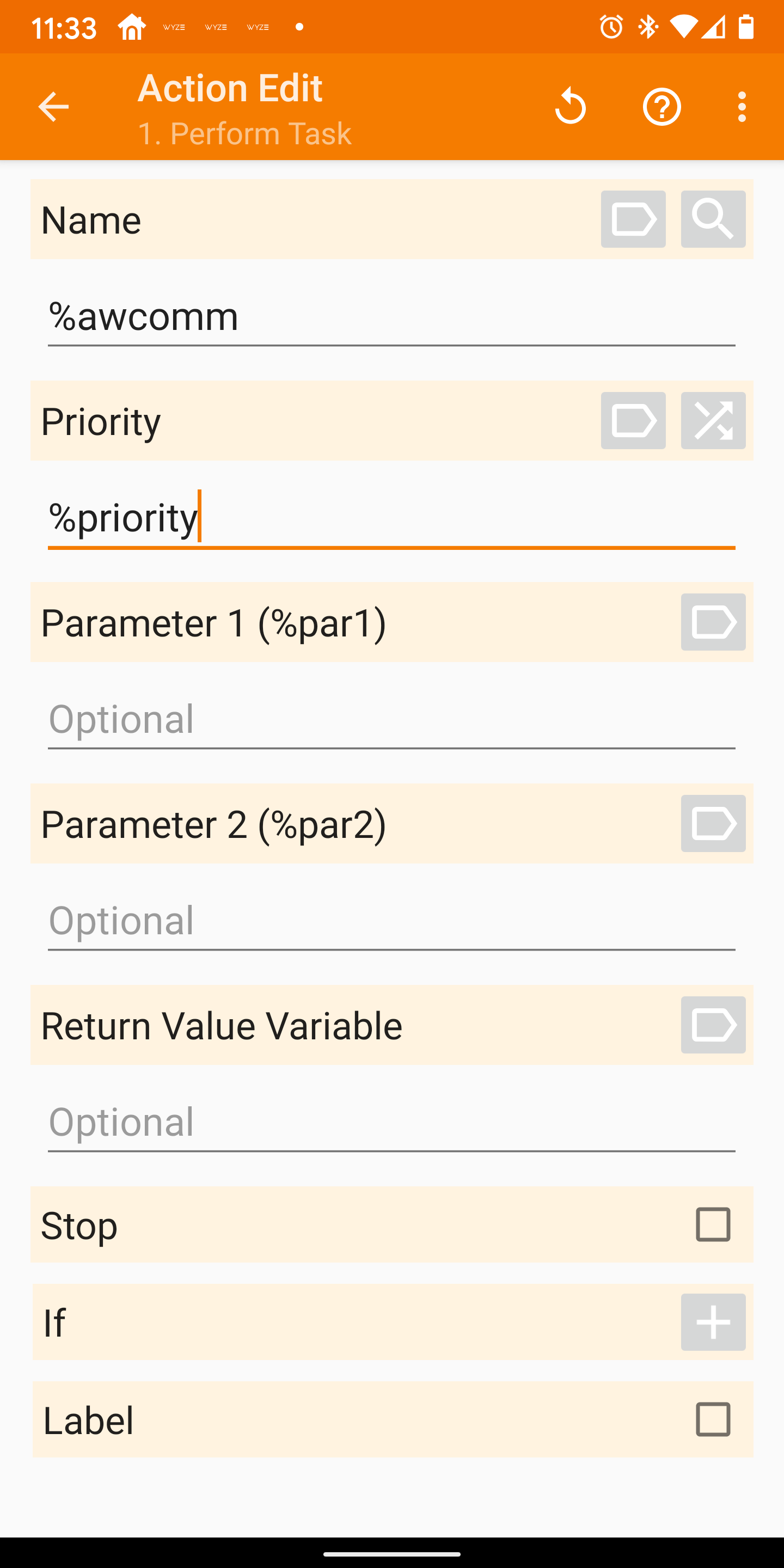

In the “Profiles” tab in Tasker click the + icon and name it “Autowear Command” and tap the checkmark. Tap “Event” from the list and then select “Plugin” and finally select “AutoWear”.
Tap the pencil icon and under “Command Filter” enter task=:=. This will match any command from AutoWear that starts with task=:=. We will configure AutoWear to issue commands of the format task=:=Task Name, for example task=:=Open Garage Direct 1. Tap the checkmark icon to accept. Then tap the arrow to accept the profile trigger.
A list of tasks to select will appear. Scroll up to see “New Task +” at the very top.
Name it “AutoWear Task Command”.
Tap the + icon and select Task and then Perform Task. Under “Name” tap the variables icon and select %awcomm from the list of variables. This variable is set by AutoWear and it includes everything after the =:=. So if we use the task name in the AutoWear commands, this little task will receive those commands and run that task by name.
NOTE: If you do not exit Tasker after making changes, in order to enable any changes you’ve made tap the checkmark icon at the top right.

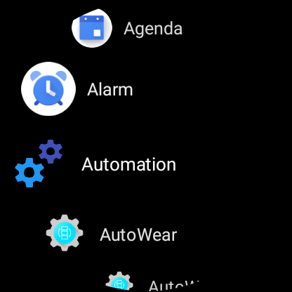

Enable a Launcher App
On your watch open AutoWear Settings. Scroll down to “Launcher Apps” and open it. You will see a list of a bunch of random seeming workds. These are the names that will be used as the application name. I chose “Automation” from the list and toggled it on.
You will now see a new application in your list of apps called “Automation”.
This is the app that we will use to launch the screen with the list of Items to tap.

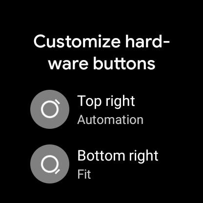

Physical Button
Many of the more recent Android Wear watches come with three buttons. Two of those three buttons can often be customized to open the app of your choice. Open settings on the watch and scroll down to “Personalization” and then to “Customize hardware buttons”. Choose which button you want to launch your AutoWear screen and choose the “Automation” app from the list.
