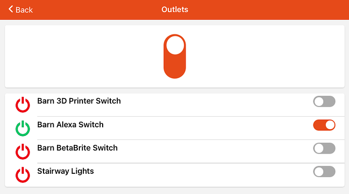

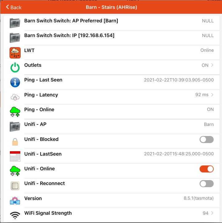

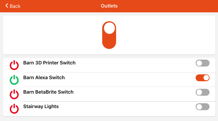

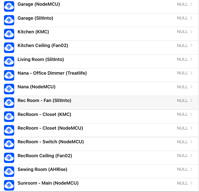

My current way of adding Tasmota devices into openhab is by using a thing/item generator that I wrote. It uses a template for different type of things, e.g. one template for lightbulbs, another for smart plugs, another for switches, etc. It makes adding / modifying / deleting tasmota devices into openhab quick and easy.
I’m curious how it would be with a dedicated binding, in any case I’ll still use my generator, just change the template to generate the things according to the binding instead of pure mqtt. At the moment we have a lot of flexibility and freedom in how to create the things / items with mqtt.
Yes, currently I also have a script creating all I need. Starting from the configuration of all my tasmota devices, pushig this to the devices, (S20,Pow,4Ch,Touch,DHT11, RGB, Moisture, Status-LED, RFID, Buzzer, …)
These Tasmota configs also contain Rules to combine the single devices with each other. But my goal is that i want to reduce the usage of rules inside the tasmota devices and replace some of them with rules in openhab. But this is for really really later (realistic guess is probably in one or two years)
For openhab I also use this script to create config files template-like for things and Models (Items with group-Tags) for my things.

/etc/openhab/things/tasmmoa.things:
// Pow-1 Kueche
  Thing topic Pow_1 "Pow Kueche (Pow-1)" @ "Küche" {
     Channels:
        Type switch : AvailabilityTopic     "Device Online State"            [ stateTopic="tele/Pow-1/LWT",         availabilityTopic="tele/Pow-1/LWT",
                                       on="Online",
                                       off="Offline"
        Type switch : Power          "Power"               [ stateTopic="stat/Pow-1/POWER", commandTopic="cmnd/Pow-1/POWER"  ]
        Type switch : Power_STATE    "Power"               [ stateTopic="tele/Pow-1/STATE",               transformationPattern="JSONPATH:$.POWER"           ]
    Type switch : Power_STATUS11 "Power"               [ stateTopic="stat/Pow-1/STATUS11",              transformationPattern="JSONPATH:$.StatusSTS.POWER" ]
    Type number : PowerLoad               "Power load"             [ unit="KWh", stateTopic="tele/Pow-1/SENSOR",   transformationPattern="JSONPATH:$.ENERGY.Power"          ]
    Type number : PowerReactive           "Power reactive"         [ unit="KWh", stateTopic="tele/Pow-1/SENSOR",   transformationPattern="JSONPATH:$.ENERGY.ReactivePower"  ]
    Type number : Voltage                 "Voltage"                [ unit="V",   stateTopic="tele/Pow-1/SENSOR",   transformationPattern="JSONPATH:$.ENERGY.Voltage"        ]
    Type number : Current                 "Current"                [ unit="A",   stateTopic="tele/Pow-1/SENSOR",   transformationPattern="JSONPATH:$.ENERGY.Current"        ]
    Type number : Total                   "Total energy"           [ unit="KWh", stateTopic="tele/Pow-1/SENSOR",   transformationPattern="JSONPATH:$.ENERGY.Total"          ]
    Type string : TotalStartTime          "Total Start Time"       [               stateTopic="tele/Pow-1/SENSOR",   transformationPattern="JSONPATH:$.ENERGY.TotalStartTime" ]
    Type number : TotalToday              "Total energy today"     [ unit="KWh", stateTopic="tele/Pow-1/SENSOR",   transformationPattern="JSONPATH:$.ENERGY.Today"          ]
    Type number : TotalYest               "Total energy yesterday" [ unit="KWh", stateTopic="tele/Pow-1/SENSOR",   transformationPattern="JSONPATH:$.ENERGY.Yesterday"      ]
    Type number : PowerLoad_STATUS10      "Power load"             [ unit="W",   stateTopic="stat/Pow-1/STATUS10", transformationPattern="JSONPATH:$.StatusSNS.ENERGY.Power"          ]
    Type number : Voltage_STATUS10        "Voltage"                [ unit="V",   stateTopic="stat/Pow-1/STATUS10", transformationPattern="JSONPATH:$.StatusSNS.ENERGY.Voltage"        ]
    Type number : Current_STATUS10        "Current"                [ unit="A",   stateTopic="stat/Pow-1/STATUS10", transformationPattern="JSONPATH:$.StatusSNS.ENERGY.Current"        ]
    Type number : Total_STATUS10          "Total energy"           [ unit="KWh", stateTopic="tele/Pow-1/STATUS10", transformationPattern="JSONPATH:$.StatusSNS.ENERGY.Total"          ]
    Type string : TotalStartTime_STATUS10 "Total Start Time"       [               stateTopic="tele/Pow-1/STATUS10", transformationPattern="JSONPATH:$.StatusSNS.ENERGY.TotalStartTime" ]
    Type number : TotalToday_STATUS10     "Total energy today"     [ unit="KWh", stateTopic="stat/Pow-1/STATUS10", transformationPattern="JSONPATH:$.StatusSNS.ENERGY.Today"          ]
    Type number : TotalYest_STATUS10      "Total energy yesterday" [ unit="KWh", stateTopic="stat/Pow-1/STATUS10", transformationPattern="JSONPATH:$.StatusSNS.ENERGY.Yesterday"      ]
         // ============= General Status Things
         Type number : UptimeSec           "Uptime sec"            [ stateTopic="tele/Pow-1/STATE",      transformationPattern="JSONPATH:$.UptimeSec"           ]
         Type number : WifiChannel         "Wifi Channel"          [ stateTopic="tele/Pow-1/STATE",      transformationPattern="JSONPATH:$.Wifi.Channel"        ]
         Type number : WifiRssi            "RSSI"                  [ stateTopic="tele/Pow-1/HASS_STATE", transformationPattern="JSONPATH:$.RSSI"                ]
         Type number : WifiRssi_STATE      "Wifi RSSI"             [ stateTopic="tele/Pow-1/STATE",      transformationPattern="JSONPATH:$.Wifi.RSSI"           ]
         Type string : WifiSsid            "Wifi SSID"             [ stateTopic="tele/Pow-1/STATE",      transformationPattern="JSONPATH:$.Wifi.SSId"           ]
         Type string : IpAddress           "IP Address"            [ stateTopic="tele/Pow-1/HASS_STATE", transformationPattern="JSONPATH:$.IPAddress"           ]
         Type string : IpAddress_STATUS5   "IP Address"            [ stateTopic="stat/Pow-1/STATUS5",    transformationPattern="JSONPATH:$.StatusNET.IPAddress" ]
         Type string : FriendlyName        "FriendlyName"          [ stateTopic="stat/Pow-1/STATUS",     transformationPattern="JSONPATH:$.Status.FriendlyName" ]
         Type string : DeviceName          "DeviceName"            [ stateTopic="stat/Pow-1/STATUS",     transformationPattern="JSONPATH:$.Status.DeviceName" ]

Some photos might be an easier way to show. I integrated Tasmota, Ping and Unifi data, and some ‘constants’ that I still need to clean up.
Outlets and sensors are grouped so they can be linked to a location in the model without bringing all of the other telemetry data with them.
I need to figure out how to create a metadata entry for the IP address item so I can jump directly to the admin console to perform upgrades or look at the console.
