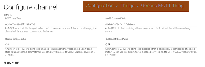

Looking at the channel syntax in your item do you have simple mode turned on? If so please turn it off and delete the item that was auto created.
Thanks, I reverberate seeing an option for easy mode, I’ll look for it now and report back shortly.
If you use PaperUI to create the Things (FYI, you can not have things in both files and PaperUI) then you can copy the channel info (to use in your Items file) and the syntax will be correct. BTW, this is the recommended way due to errors with channel syntax.
Thanks, This is a new menu for me so I’ll have to figure it out, it’s not making sense to me just yet.
So I have turned off Easy mode and recreated my generic mqtt thing.

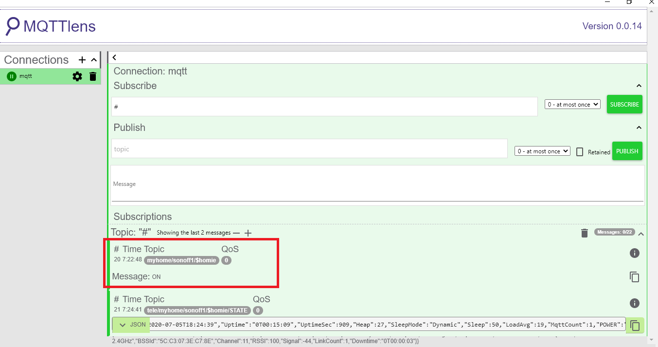

I also forgot to add this screenshot, this is what I am seeing on mqtt Lens:-

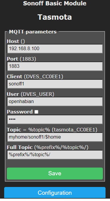

Screen shot has the topic as tele/myhome/sonoff1/$homie have you tried that in the config?
Do you mean in the Tasmota config? I didn’t think of it, I’ll try it after dinner and report back.
Thanks!
Hi!
I made some changes as per your suggestion and I’m now getting some reaction from Tasmota on the console!! It is saying " {“Command”:“Unknown”} " but at least it is receiving a message!
It is working!!! Thank you for the above screenshot of your setup, it hit that final nail in and started to work!
