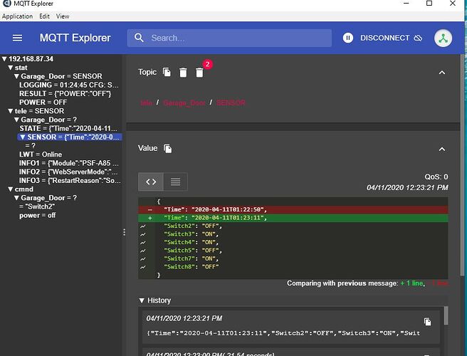

I’ve read the Tasmota doc’s but it’s not clear to me…Running MQTT Explorer as below I can see the status is reporting each 5minutes but how do I setup my channel to track this status?

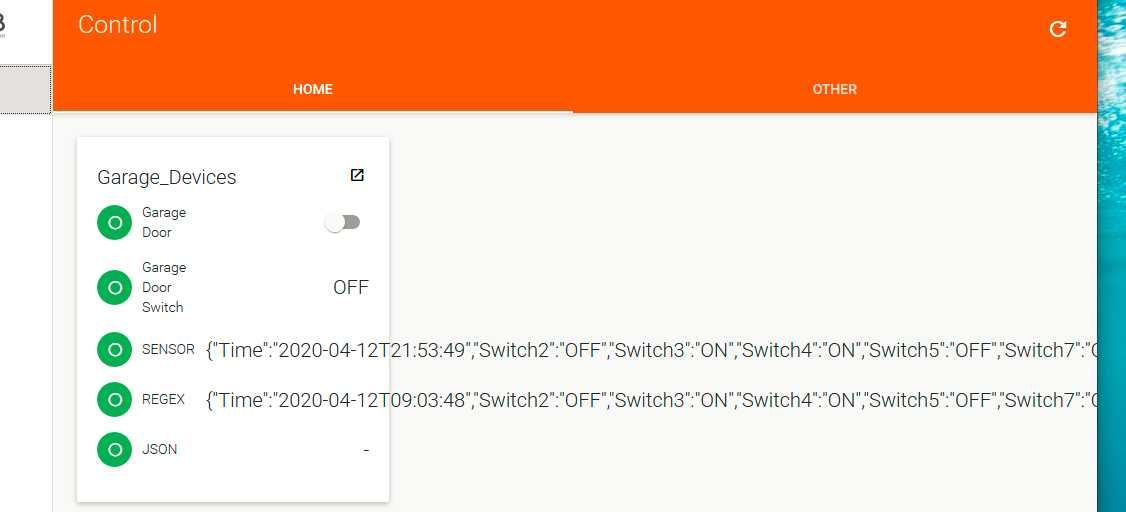

Thanks tht helps a bit… I’m trying to keep in Paper UI, but with these examples I’ve managed to get the full array presenting in Paper UI. Now just trying to present the state of individual elements ie: Switch 3, but REGEX doesn’t seem to work for me, documentation on is has no examples within Paper UI?

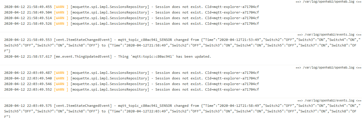

Here’s my log showing items I’m trying to breakout and present:

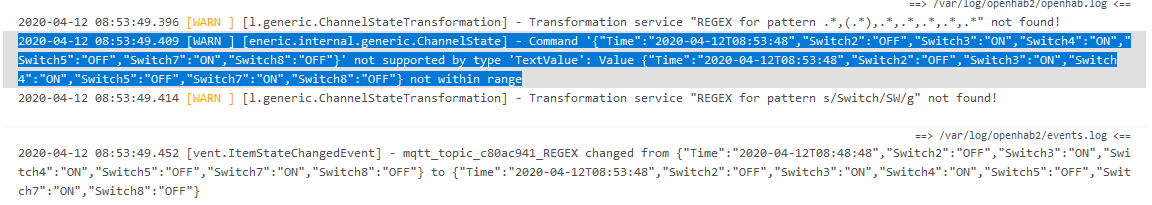

It says … Transformation service REGEX not found.
REGEX is installable, like JSONPATH service.

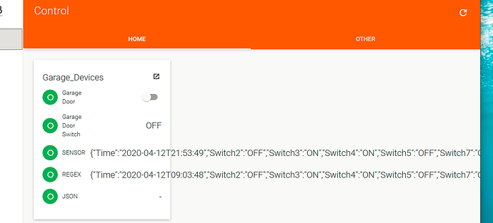

Here’s a bit more info / screenshots:
Since last post I had moved the REGEX statement to Transformation line as was part of status command line before, now logs as above don’t seem to even attempt REGEX component?
That all seems to be doing what you told it to do.

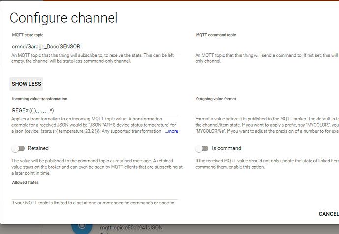

You might want to click the “more” under Incoming Value transformation
You probably need to show us what you’ve done now, then. I don’t know what a status command line is in this context.

I did have the MQTT State Topic as cmnd/Garage_Door/SENSOR:REGEX:((.),.,.,.,.,.,.*) when it was complaining about REGEX no being present yet it’s installed.

There is an example in your earlier screenshot
As per your screenshot, it goes in the “Incoming value transformation” box.
I’ve no idea what your given REGEX should be expected to do, though.
Me, I’d use JSONPATH instead and put
JSONPATH:$.Switch3
in the box.
