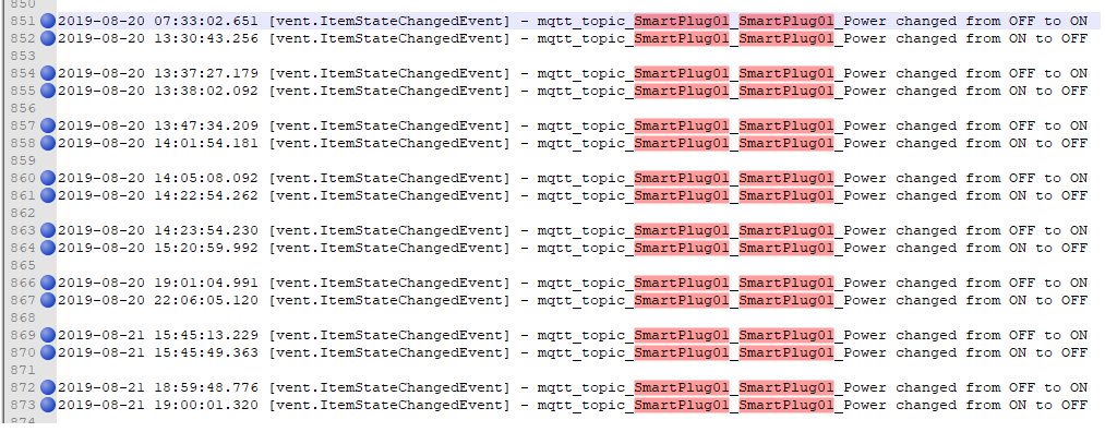

Only one of these plugs is currently connected to a Lamp, and I have the problem that this lamp is switching on and of randomly and I do not find the cause for this.
In the OpenHAB event.log I can see the incoming notifications that the Plug switched on and off, but there is no command visible to have initiated that. There is also no visible pattern in the on/off-times (see attached logprint). There are no timers programmed in the UI of the smart plug. And this is where I am running out of ideas.
Apparently the switching originates within the tasmota-device. What could be the reason?
