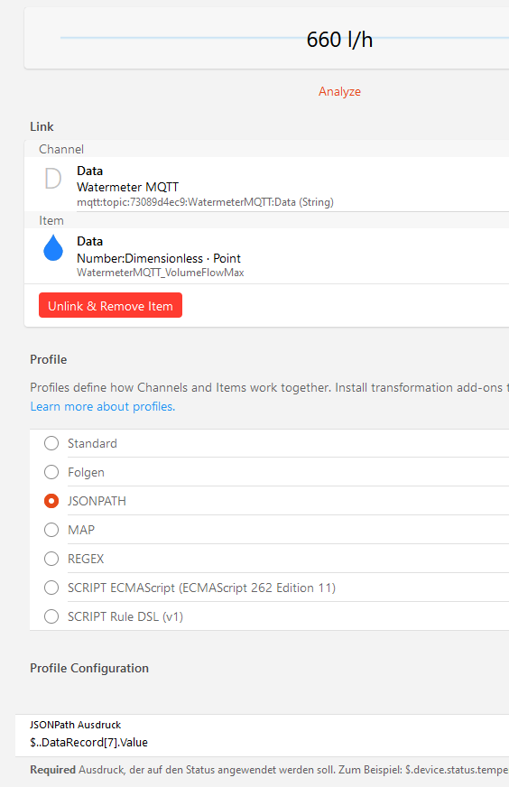

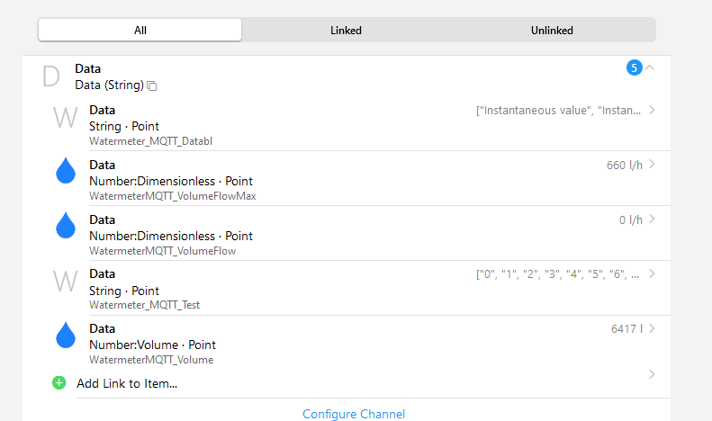

I read out an M-Bus (wired) subscriber as follows.
Hardware Raspberry Pi with USB M-Bus adapter, on the Pi is running software according to instructions from here:
I have created a generic MQTT Thing on openHAB:
UID: mqtt:topic:73089d4ec9:WatermeterMQTT
label: Watermeter MQTT
thingTypeUID: mqtt:topic
configuration: {}
bridgeUID: mqtt:broker:73089d4ec9
channels:
  - id: Data
    channelTypeUID: mqtt:string
    label: Data
    description: ""
    configuration:
      stateTopic: mbusmeters/360295669215FF16
With channels:
The data is then read from the items using JSONPath:
