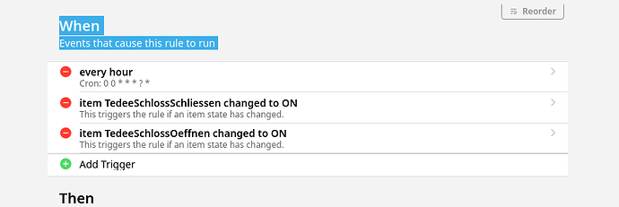

If I put all scripts in one rule, I like to trigger the state of lock and bridge with cron job (every hour), and locking or unlocking with two items. All three triggers are in the condition field. How can I separate them in the program, because event.itemName from cron job is ‘undefined’.
If you only have the one thing you want to do with the cron job (get the state of the lock and bridge) then you have your answer.
// Do common stuff
if(event.itemName === undefined) {
  // cron or manually triggered, get the status
else if(event.itemName == "MyItem1") {
  // do stuff for MyItem1
else if(event.itemName == "MyItem2") {
  // do stuff for MyItem2
// Do closing common stuff if necessary
That’s the simple and most straightforward approach.

That is the final story for the moment. I will get the Status of lock and bridge via webhooks, which will shorten the rule. also a lot of error messages are needed.
