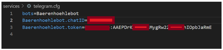

Hi @waitz_sebastian thanks for this informations. i hope i am “allowed” to ask this here: i have successfully opended a Bot, and he sends me messages to my account. I created a group, i put the bot in, and activated him as admin.
But i am not sure where to configure this new chat group with the ID to my openhab2 via visual studio code. Do i have to put this chat id of the group additionally to the general telegram.cfg, or just in the rules using messages to this group?
I tried both, and nothing worked. ![]()
Hey @EnergieS, You have to update your telegram.cfg in services folder. Just add the group as a second bot to “bots” variable which is comma separated.
Than than add a another chatID like this:
bots=chat1,chat2
chat1.chatId=123456
chat2.chatId=-987655
