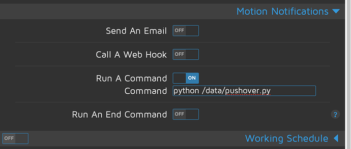

This is my solution to send the last photo in telegram
import time
import datetime
import os
import glob
ts = time.time()
stfolder = datetime.datetime.fromtimestamp(ts).strftime(‘%Y-%m-%d’)
print(stfolder)
list_of_files = glob.glob(‘/data/output/Camera1/’ + stfolder + ‘/*’)
latest_file = max(list_of_files, key=os.path.getmtime)
final_path = “@”+latest_file
print(final_path)
final = “curl -s -X POST ‘https://api.telegram.org/botXXXXXXXXXX:YYYYYYYYYYYYYYYYYYYYYYY/sendPhoto’ -F chat_id=-XXXXXXXXXXXXX -F photo=” + final_path + " -F caption=‘Alarm/Carefull!!!’"
os.system(final)
Captura de Pantalla 2021-11-21 a la(s) 1.17.23
