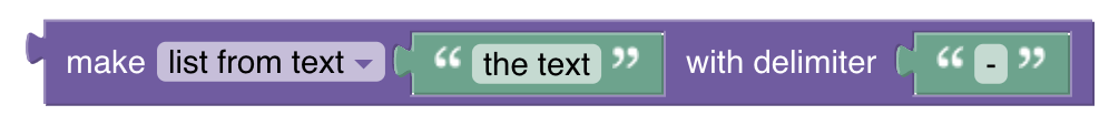

The syntax will be different depending on the rules language you are using. @Baschtlwaschtl shows how to do it in Rules DSL.
Blockly:
Obviously, you’d replace the “the text” with the “get state from Item” block.
