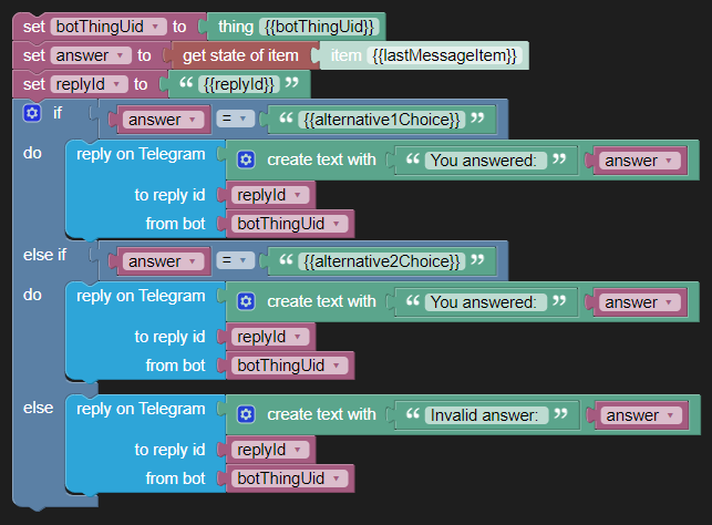

This rule template will build the skeleton of a rule processing answers to a Telegram query.
A query is a message from a bot with buttons similar to this:
Clicking on a button will update items provided they are linked to the proper channels of the Telegram bot Thing.
This rule template, combined with the Telegram block library, can be used to build complex conversations with a Telegram bot.
The rule will build a Blockly action looking like this ({{placeholders}} will be replaced with the actual values you select when creating the rule from the template):
You should keep the “reply on Telegram” blocks (change the message as you like) but can add more blocks to the alternative branches of the “if” block to perform actions as desired.
You can even use the “ask on Telegram” block to continue the conversation - just be sure to choose another replyId, and create another rule from this template to respond to this new replyId!

      type: application/javascript
      script: >
        var botThingUid, answer, replyId;
        var things = Java.type('org.openhab.core.model.script.actions.Things');
        botThingUid = '{{botThingUid}}';
        answer = itemRegistry.getItem('{{lastMessageItem}}').getState();
        replyId = '{{replyId}}';
        if (answer == '{{alternative1Choice}}') {
          things.getActions('telegram', botThingUid).sendTelegramAnswer(replyId, 'You answered: ' + String(answer));
        } else if (answer == '{{alternative2Choice}}') {
        } else {
          things.getActions('telegram', botThingUid).sendTelegramAnswer(replyId, 'Invalid answer: ' + String(answer));
    type: script.ScriptAction
