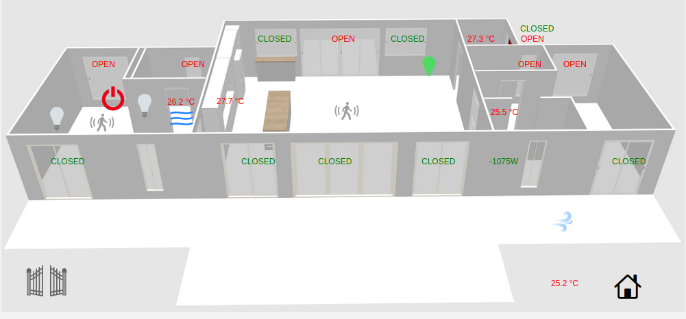

Dashboard updates as soon as the item changes. So you don’t need to reload the page
