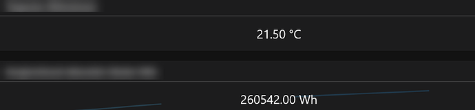

I am unable to display a widget with a graph for a (homematic IP) temperature sensor on my overview page. Other graphs are showing fine, but not for this item. The temperature value is being shown as expected:
When I click on the widget to see the details, the graphs show correctly for the different time periods, so the data is there.
I added the widget like the other ones that work, selected the point of the item for the actual temperature, the widgets is being displayed but the graph is missing. If I do the exact same thing for example for the item/point you see on the bottom of the screenshot it works.
