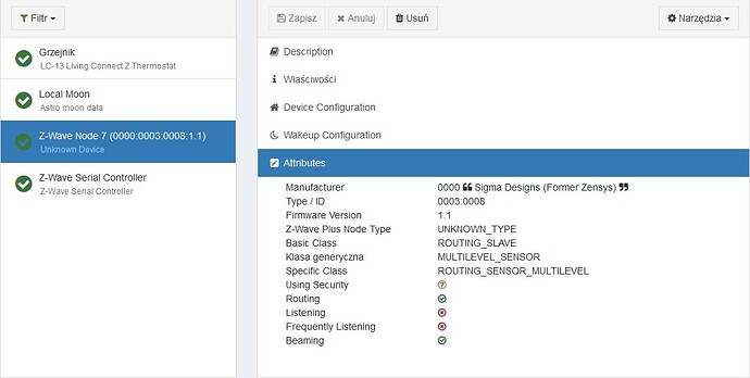

Hi, I have a problem with configuration M417_9E, im found device on site
http://www.cd-jackson.com/index.php/zwave/zwave-device-database/zwave-device-list/devicesummary/422?layout=openhab2
but i don’t understand where/how i should addition.
temperature humid zwave Sigma Designs M417_9E
os: Debian Habmin 2.2
Z-Wave USB Stick ZMEEUZB1
 root@Traccar:/var/lib/openhab2# ls
cache   etc     jsondb  log        persistence  uuid
config  habmin  kar     myopenhab  tmp          zwave
root@Traccar:/var/lib/openhab2/zwave# ls
1.xml  node1.xml  node2.xml  node3.xml  node4.xml  node7.xml

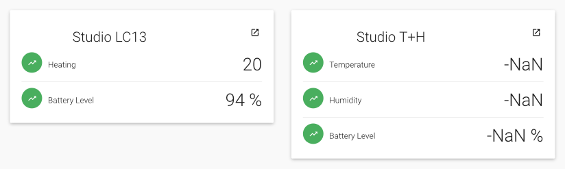

Thanks Chris for your support, even on xmas day! :slight_smile: The item was detected as node3 but no xml was generated. After another three wake cycles, it finally generated the XML: as expected, the device is detected as Heiman HS1HT.
Problem is, now all the channels are reported as NaN:

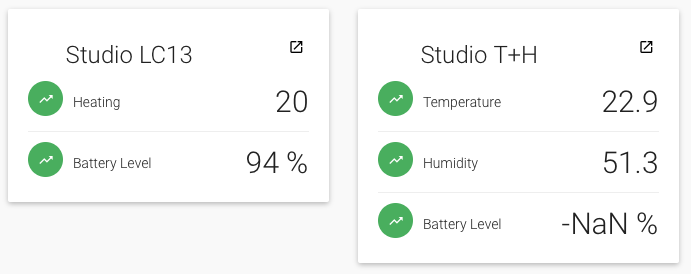

I’ll wait a couple of refreshes and see what happens.
Ok - actually after the first refresh everything T & H signals works properly, the battery level is still failing…
In the logs, only two channels have been updated:
2017-12-25 23:55:30.368 [GroupItemStateChangedEvent] - gTemperature changed from NULL to 22.9 through Studio_Temperature
2017-12-25 23:55:30.375 [vent.ItemStateChangedEvent] - Studio_Temperature changed from NULL to 22.9
2017-12-25 23:55:31.509 [vent.ItemStateChangedEvent] - Studio_Humidity changed from NULL to 51.25
2017-12-25 23:55:31.514 [GroupItemStateChangedEvent] - gHumidity changed from NULL to 51.25 through Studio_Humidity
2017-12-25 23:55:32.952 [me.event.ThingUpdatedEvent] - Thing ‘zwave:device:fda67070:node3’ has been updated.
Ok, that’s good - this version might be a bit more official… Ones that are detected as Sigma Designs are likely to be the problematic ones…
Is it updated yet? It takes longer to update the battery.
It took some time to update, but after few hours it did:
2017-12-25 23:20:19.138 [.ItemChannelLinkAddedEvent] - Link ‘StudioTH_BatteryLevel-zwave:device:fda67070:node3:battery-level’ has been added.
2017-12-26 08:15:17.222 [vent.ItemStateChangedEvent] - StudioTH_BatteryLevel changed from NULL to 44
This one seems to be working properly (it’s just a bit funny that it came brand new with such a low battery, but it was really cheap - half of the price of other sensors).
