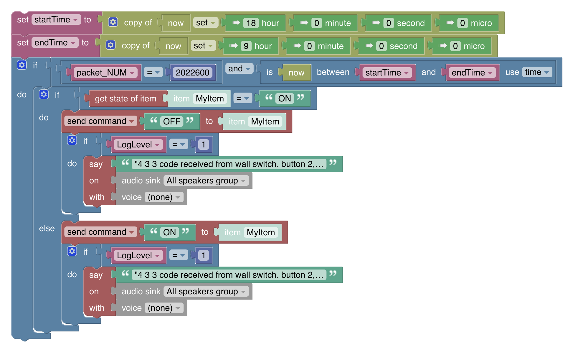

For example, hereās a blockly script I use as a scratchpad as it appears in the JSONDB. First the rendered version:

Unfortunately certain characters need to be URL encoded which makes using the raw JSON a little troublesome. But the history is preserved well when checked into git. And the YAML you see on the code tab in MainUI is quite usable. This is a Script so thereās no code tab :-(. But you can see the JS created from the Blockly editor:
