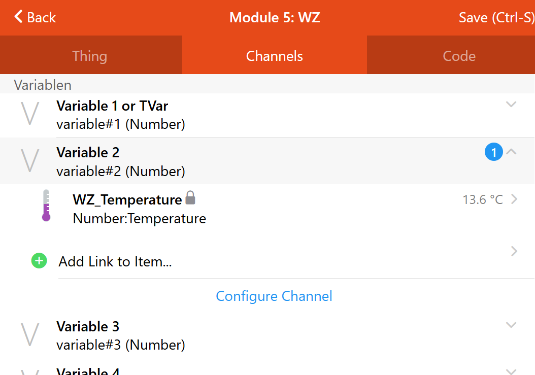

You need to set the unit under “Configure Channel”:
You should see changes in setpoints within LCN-PCHK.
Wow, Thanks! I hope all my problems are so easily solved!

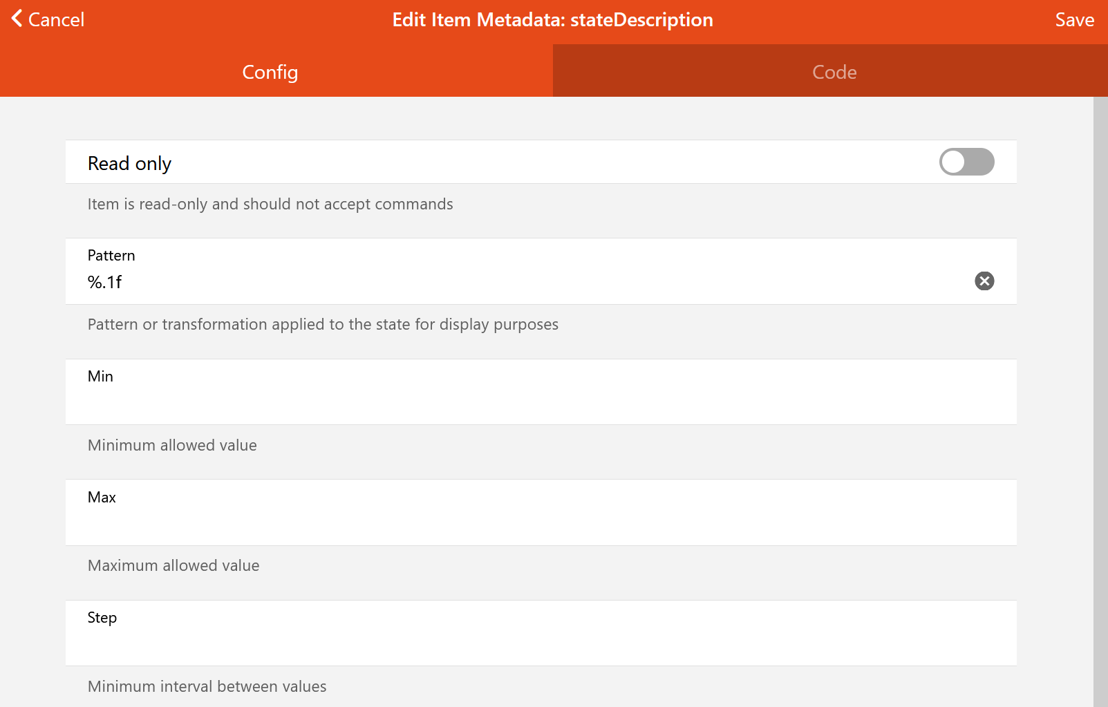

Hi, but the Value is not a decimal number.
How can i change this?
Thanks for help.
In MainUI, you can add a State Description by clicking on “Add Metadata” in the Item and enter the pattern “%.1f”:
Perfect, thank you very much. It works :grinning_face:
