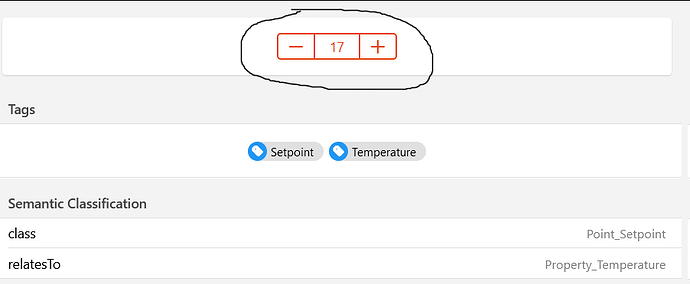

I just checked and I also have ā€˜state description’ set. Just ā€˜add metadata’ → ā€˜state description’ and also set here the min/max/step and don’t forget to set the pattern to ā€˜%0.1f’. Then save but also go back to the item overview. Somehow you need to do this before this is activated.
If you now select the item (search bar) you should be able to have a stepping setpoint.
In short:
  • define item als ā€˜temperature:setpoint’,
  • set semantic class as setpoint and semantic property as temperature
  • set state description
  • set default list item widget
and then magic should happen. :slight_smile:
