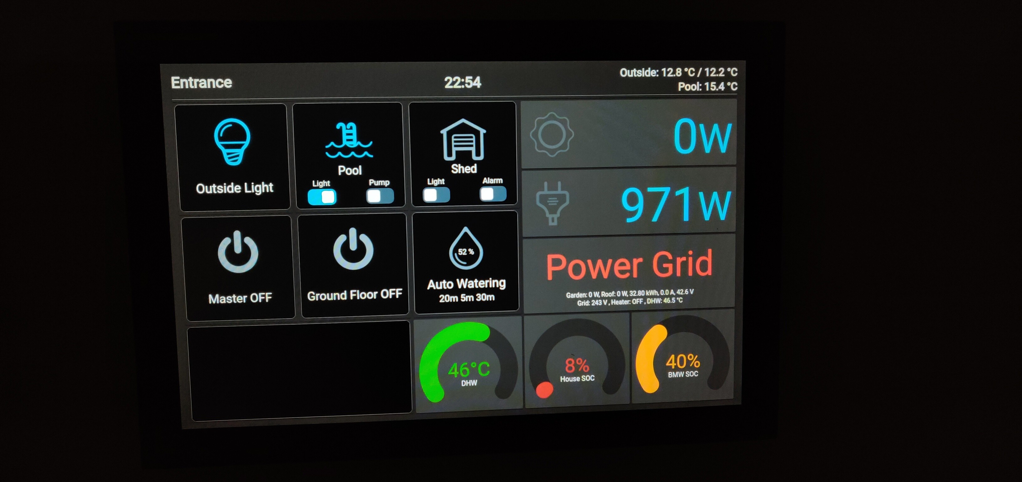

Here is the code it is based on my rouded square switch template that was posted here in the early days of habpanel. Code is very not optimized, mostly trial and error to fit my tablet nicely.
Main icon is also clickable and the is equal to lower left function. lower right is seconary function relating to the main one.

You also need a css , That @badsl posted on the top of the page.
The whole panel looks the folowing now
