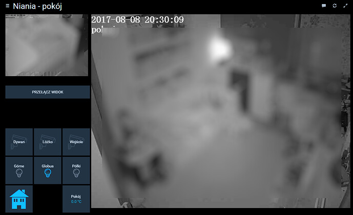

Hi!

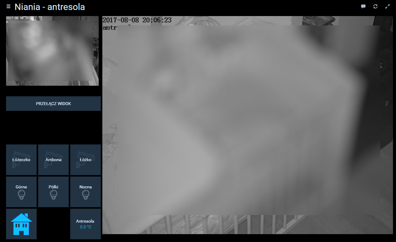

I have 2 dashboards as on the attached screenshots which shows view from 2 foscam cameras (each for one room) which I use to keep an eye on my children. 1 smaller and 1 bigger image combination depending on selected dashboard (each for one room).
In order to switch cameras I use Button widget (labeled as “PRZELACZ WIDOK”) which just navigates to the other dashboard showing exchanged view of cameras and different switches.
Both cameras provide MJPEG streams which are supported by Image widget. However Image widget doesn’t provide possibility for editing exact picture size. Also Image widget does not provide options “Don’t wrap in container” and “No background”. Therefore I decided to use Template widget.
The code in Template widget is as follows:
<a href="/habpanel/index.html#/view/Pokoj"><img src ="http://192.168.1.13:8888/cgi-bin/CGIStream.cgi?cmd=GetMJStream&usr=xxx&pwd=xxx" height="720" width="960" ></img></a>

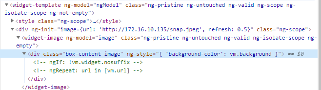

Got it working with your example but I I want to pass the url from the item and that will not work for a reason I do not understand.
This one works perfectly.
<div ng-init="image={url: 'http://172.16.10.135/snap.jpeg', refresh: 0.5} " >
<widget-image ng-model="image" ></widget-image>
While this will result in empty image
<div ng-init="image={url: '{{'%s' | sprintf: itemValue('trash_icon_url2')}}', refresh: 0.5} " >

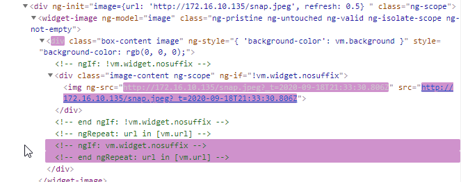

And I see in inspect that it gets substituted perfectly
The only one diffrence I see in inspect that when I just enter url manualy it will for some reason get a timestamp added, I kind of do not understand why that does not happen when I pass that as item value.
