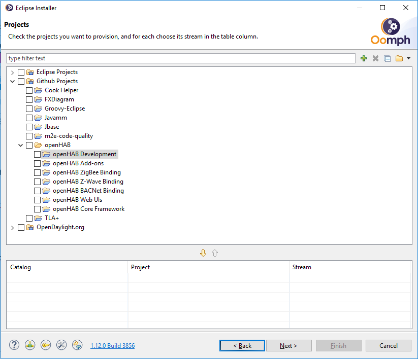

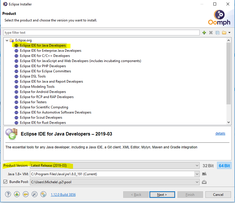

Start from a new Eclipse by installing the selecting laster 03-2019 you do not install any OH component selected.
Once the installation is complete, you need to clone the latest repositories as per the guide.

Eclipse Version is 2019-3
After selecting laster 03-2019 you do not see any OH component selected.
