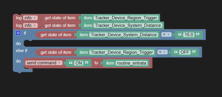

good morning, I have a problem with this rule. I have two routines: entry and exit. With the gptracker binding I would like it to activate the “entry” rule when I am close to home. I use the “distance” channel for the position and the “region” channel as the flag. The problem is that in the exit phase, I should time the rule to give you time to “exit” from region and distance, otherwise it reactivates “entry” for me. I attach the code, thanks for the suggestions.
I forgot… the radius is 10

type: application/javascript
script: >
console.info(items.getItem('Tracker_Device_Region_Trigger').state);
console.info(items.getItem('Tracker_Device_System_Distance').state);
if (items.getItem('Tracker_Device_System_Distance').state < '15.0') {
} else if (items.getItem('Tracker_Device_Region_Trigger').state == 'OFF') {
items.getItem('routine_entrata').sendCommand('ON');
type: script.ScriptAction
