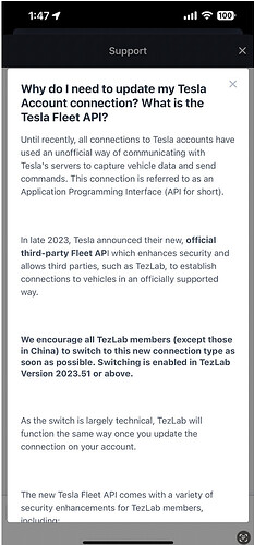

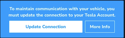

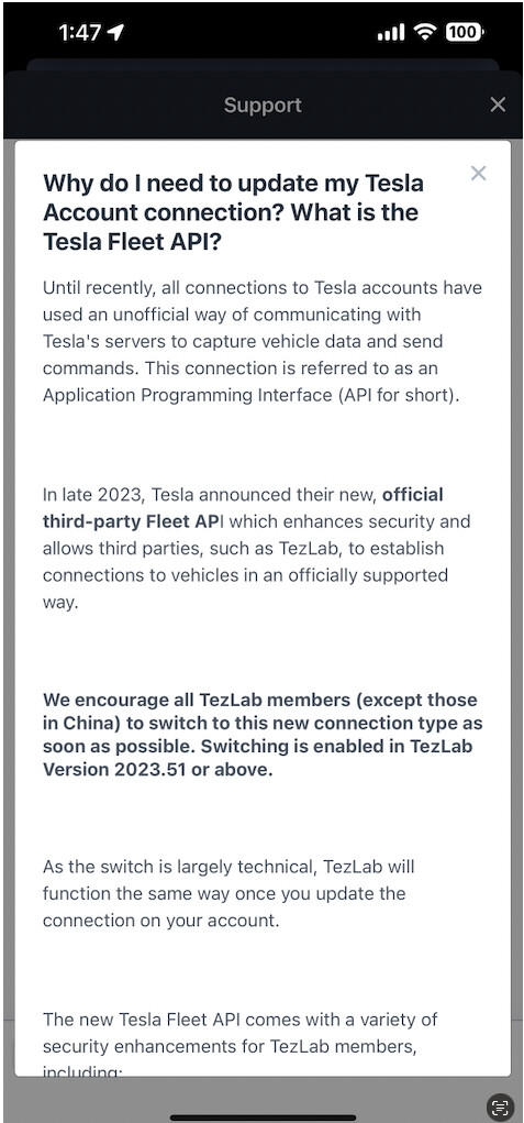

I decided to check if TezLab, which also uses API access, can connect to my car. It does seem to, but it also is prompting me to update my connection:
This could be a wild goose chase, but here’s what they have to say about that:
I did follow their guidance and updated, but for the record, TezLab was communicating with my car before I updated the connection, and seems to be working fine after the update.
