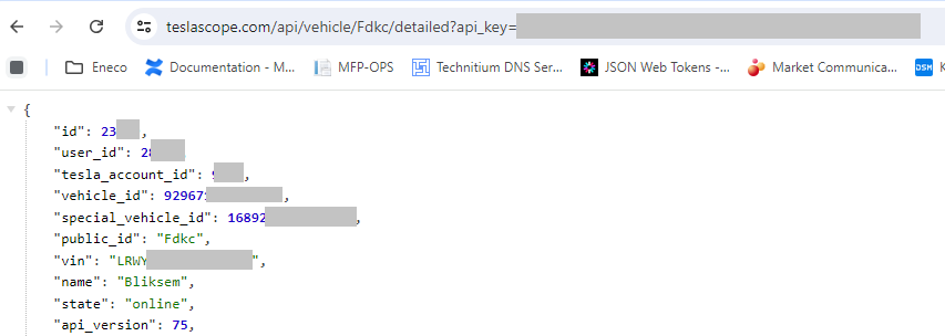

I have installed and tried the binding. However, as soon as I enable an error is shown
Cannot invoke “com.google.gson.JsonElement.getAsJsonObject()” because the return value of “com.google.gson.JsonObject.get(String)” is null
while the url that will be build in the code acctually returns a response
Make sure your api_key is entered correctly in the config. I got bitten in testing as double clicking it to ‘copy’ missed the part after the hyphen. I’ll work on adding some code to catch the error returned by Teslascope and give something a bit more useful than a Json error.

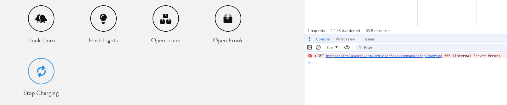

The binding itself seems to work. Reading the date goes fine. Commands are failing with a 500 response from the API, although that seems a teslascope issue since in their portal it doesn’t work either. I’ll check again later.
Thanks for the good work.
For commands, make sure you’ve setup a virtual key via Tesla scope.
I don’t wanne make you tesla scope support center.. but the key is configured fine.
although even from within teslascope itself it’s resulting in an error
Interesting! Commands are definitely working for me - perhaps check the keys in your car and see if Teslascope is listed as having access.
