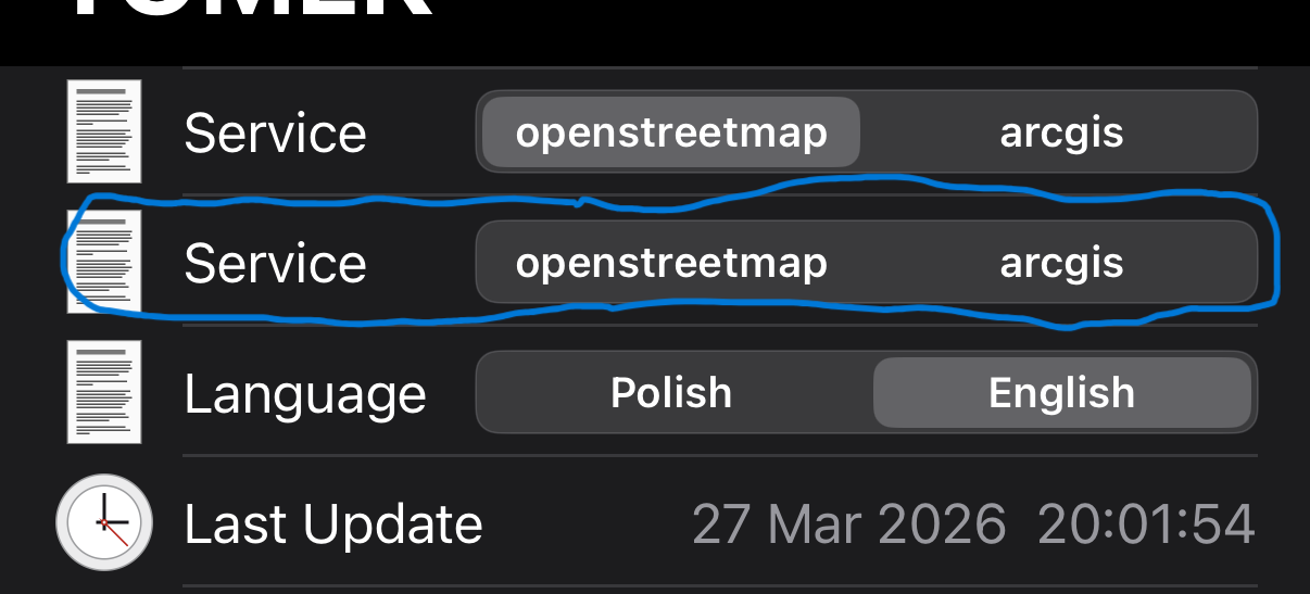

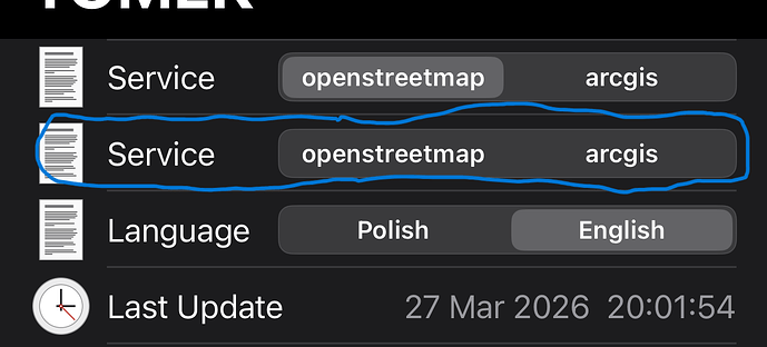

See the blue region on the picture below - The button, when pressed, is highlighted only temporarily and not kept when app restarted or page changed. The state is changed properly anyway. It is just a problem with the display.
The problem is when the item is of Number type.
Item definition:
Number aaa “aaa” { stateDescription=“0=openstreetmap, 1=arcgis” }
Sitemap:
Default icon=text item=aaa label=“Service”
The problem does not appear for the String type item - see below for the “Language” where the definition is:
String bbb “bbb” { stateDescription=“pl=Polish, en=English” }
Sitemap:
Default icon=text item=bbb label=“Language”
The top case on the picture below is a workaround with a Number item and Switch widget in the sitemap (it works):
Switch icon=text label=“Service” item=aaa mappings=[0=openstreetmap, 1=arcgis]
