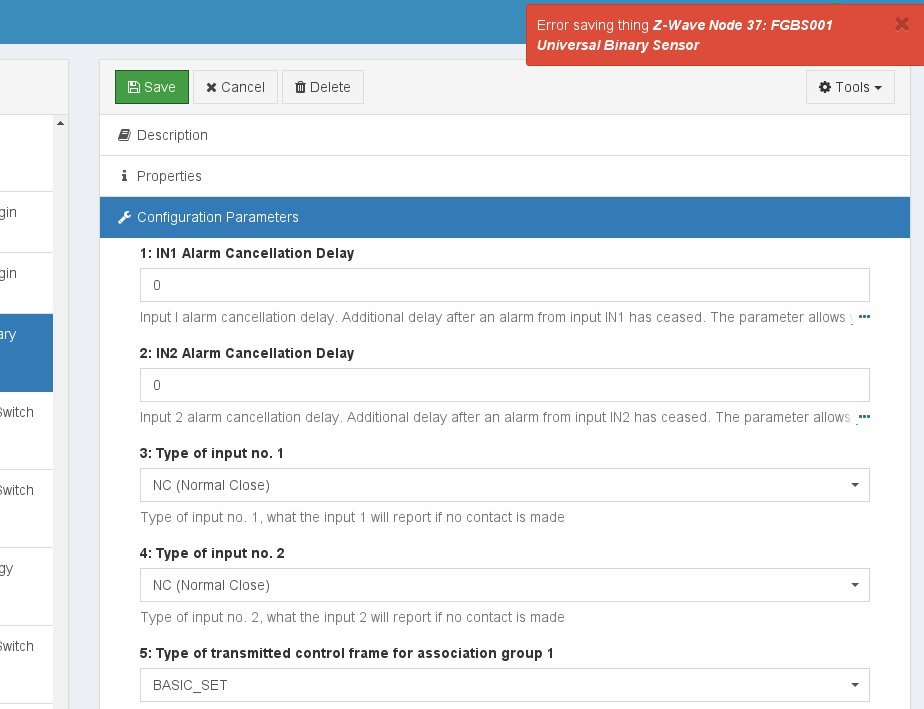

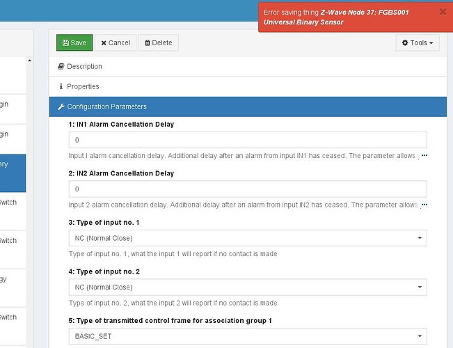

I’m trying to get habmin configuration to work, I don’t know if you remember, but I have had issues with it earlier. Anyway, I can change a name of a thing, as well as polling period. But if I e.g. want to change a node setting, e.g. association group or a configuration parameter, after I press the green save, I get:
