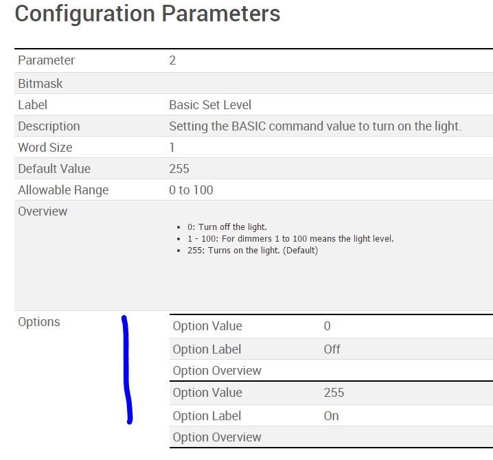

regarding editing stuff in the DB
for the devolo http://www.cd-jackson.com/index.php/zwave/zwave-device-database/zwave-device-list/devicesummary/290
  1. I would like to delete the Options from the database (parameters 2,3,4)
    No possibility to do so :slight_smile:
  2. also the Command Classes are not ok (they are populated from the XML?)
    e.g. there is DOOR_LOCK in there which is not available for the PIR sensor
    delete these non correct classes seems also not available to me?
thanks

Why? I just looked at parameter 2, and it looks ok - doesn’t it?
just the Options part of these parameters. (2, 3, 4)
I understood that, but my question is what is wrong with this. If I look at your example above, we have option 0=Off, and it says exactly this in the Overview - same for 255=On. I’m not sure what is wrong with the definitions?
I thought the1-100 in the overview might be a wanted setting for some users?
Of course, you can write this sort of thing in the overview as well - that’s fine.
I saw you updated the device… just to understand
when there are Options. These are the only possible setting I can do for that parameter.
Eg. Parameter 3 → PIR Sensitivity 1-99
there is still a “Option” which will block me from entering any value from 1-99 I would like to enter
