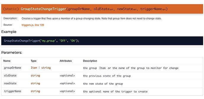

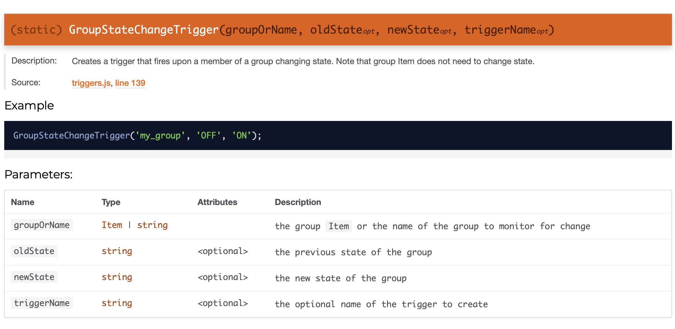

As an example, I’m using the GroupStateChangeTrigger, for which the documentation says that the oldState is optional.
However, this seems a bit misleading. If I write the rule as follows, OH takes it as “when the group_Override_Automated_Scenes changes from ON to anything”:
triggers: [triggers.GroupStateChangeTrigger('group_Override_Automated_Scenes','ON')],
If I write the rule with an additional comma without parameters in between, there is an error:
triggers: [triggers.GroupStateChangeTrigger('group_Override_Automated_Scenes', ,'ON')],
How could I achieve this without writing multiple rules for each “old state”?

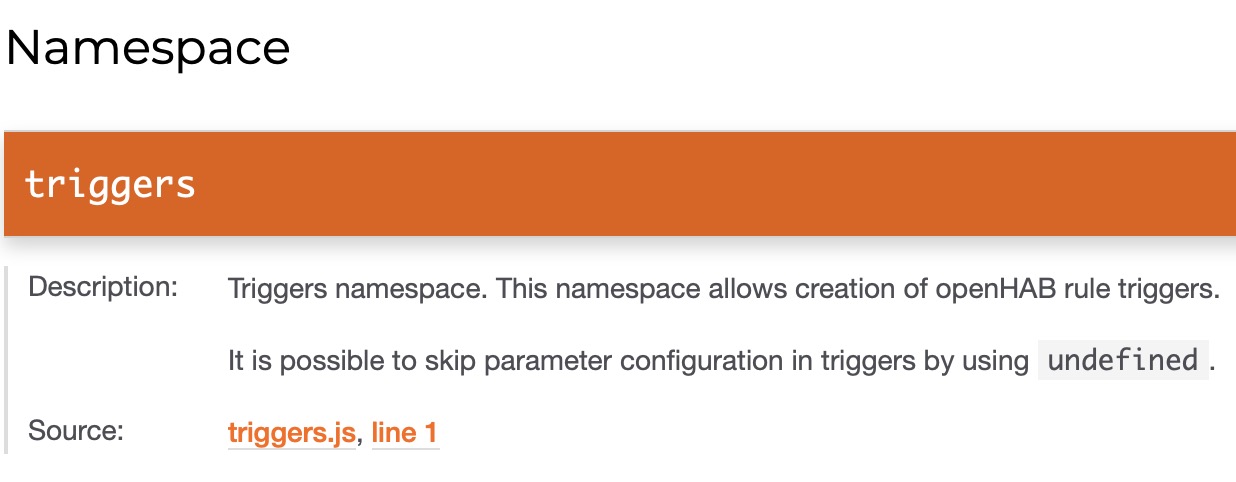

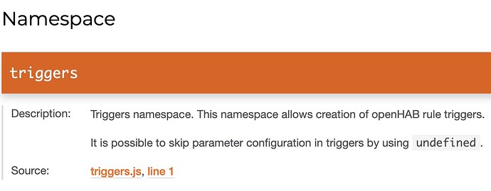

Try it with
triggers: [triggers.GroupStateChangeTrigger('group_Override_Automated_Scenes', undefined,'ON')]
This should be “from any state to ON”
Thanks, @Darkem.
You’re right. I had forgotten it.
