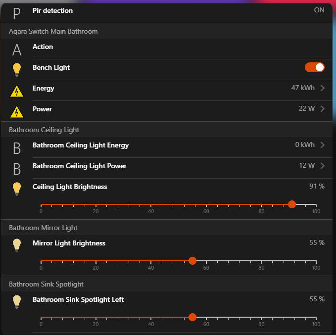

Here is an example of where it becomes problematic. There’s three sliders in a row and they go for almost the full widith of the window. Almost no matter where I put my finger I will modify the dimming value of at least one of the lights. Almost impossible to scroll without doing so. I’m not aware of any setting that could affect this.

The problem isn’t limited to your installation, I have the exact same problem. The sliders in particular are very problematic when scrolling, but I’m not sure that they are the only controls with the problem. They are definitively where the problem manifests most often though.

I don’t think there’s any specific setting to fix it at the moment, but you can mitigate the issue, perhaps. I use MainUI exclusively and I use it heavily on several different touchscreens and I had never encountered this issue until I saw this post. I was curious why this had never been an issue for me until I saw your example image.
The lists in the model cards by default are expanded like in your image, but I long ago changed the setting that makes each equipment a collapsed accordion button. Scrolling does not interact with the accordion items. Yes, there’s one extra click to open any equipment you want to interact with, but on the other hand, I’ve never once touched a slider while scrolling.
I suspect that the problem is inherent to the f7 library, but it might be fixable by simply setting draggable-bar to false on the slider items when they’re in a model card.
