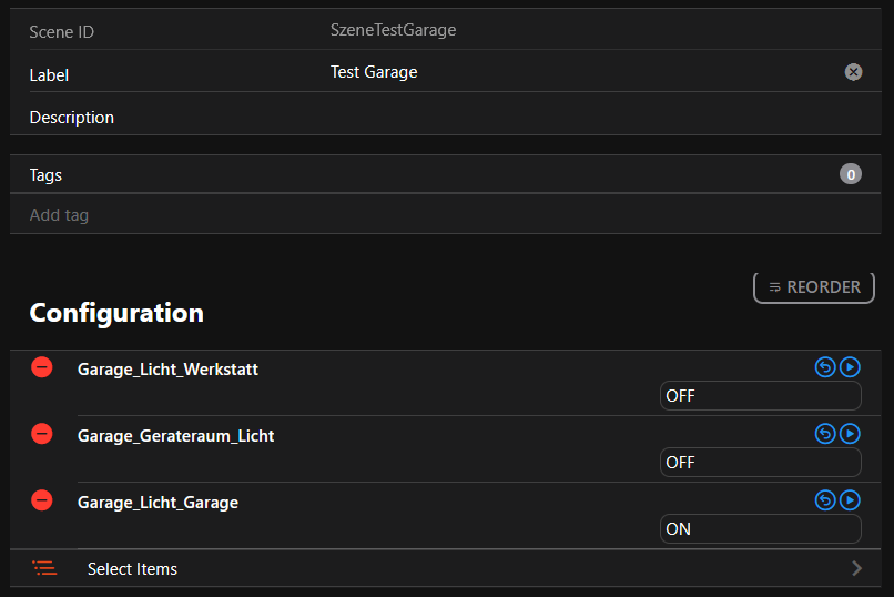

I did a Test with my garage Lights:
my Test Scene:
my ON/OFF representing Item

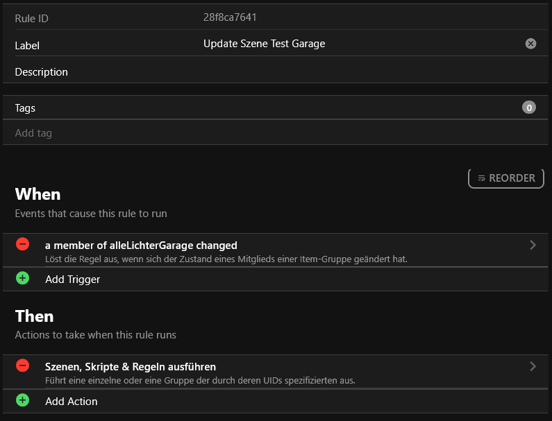

and the rule
configuration: {}
triggers:
  - id: "1"
    configuration:
      groupName: alleLichterGarage
    type: core.GroupStateChangeTrigger
conditions: []
actions:
  - inputs: {}
    configuration:
      considerConditions: true
      ruleUIDs:
        - 50a916fd9b
    type: core.RunRuleAction
