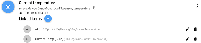

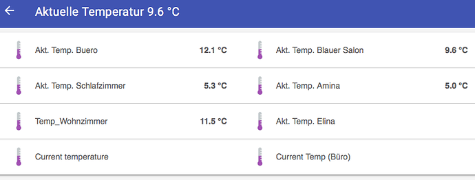

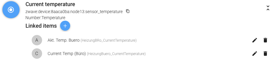

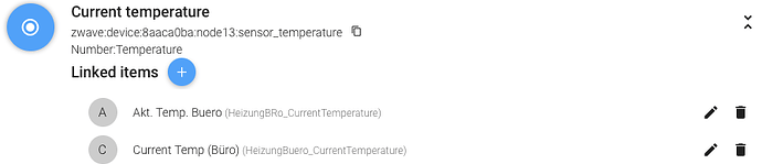

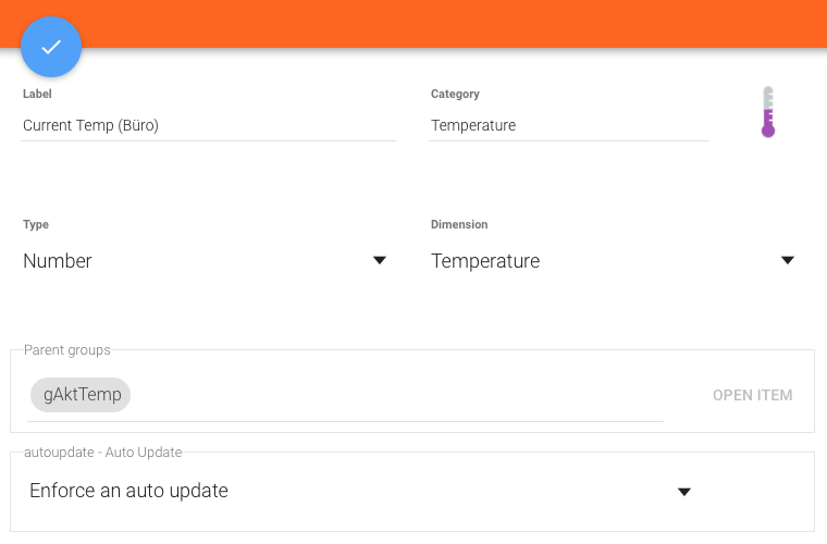

I create, to a channel of a zWave- Thing, an item (HeizungBuero_CurrentTemperature) via Paper UI and add it to a group. In the Basic UI I show all values of this group:

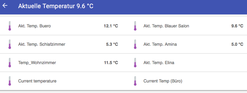

Group item=gAktTemp label=“Current Temperature [%.1f °C]”
If I name it according to my default, then the value change for the item is logged, but in the Basic UI there is nothing. Not even a “-”. As if the item was not initialized at all.
To illustrate, I created a second item and also linked it to the same channel. The settings are exactly the same. Here I get values displayed in the Basic UI. It seems that there is a problem with the name. I don’t understand which one?

The value of the second item (HeizungBRo_CurrentTemperature) is displayed, the first item remains empty in the Basic UI. It seems like there is a problem with the name. I don’t understand which one?

If that’s the one that does not display, this is the Item we need to see your definition of.
